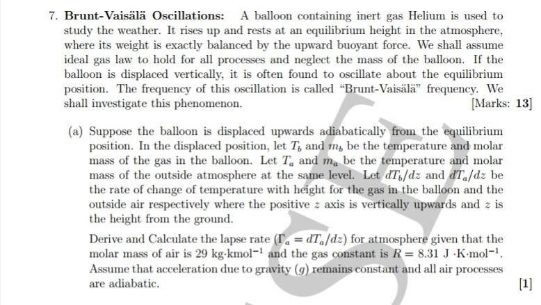

An air parcel is investigated to study the weather.It rises up and rests at an equilibrium height in the atmosphere,where its weight is exactly balanced by the upward buoyant force. We shall assume
ideal gas law to hold for all processes and neglect the mass of the air parcel. If the air parcel is displaced vertically, it is often found to oscillate about the equilibrium position. The frequency of this oscillation is called “Brunt-Vais¨al¨a” frequency. Now suppose the air parcel is displaced upwards adiabatically from the equilibrium
position. Let M(b) and M(a)be the molar mass of the air parcel and the atmosphere respectively.and C(b) and C(a) be the molar heat capacity at constant volume for the air parcel and the atmosphere respectively .
Find the equilibrium height of the air parcel.
Hints:First find the lapse rate for both the air parcel and the atmosphere. Then find out the acceleration of the air parcel.

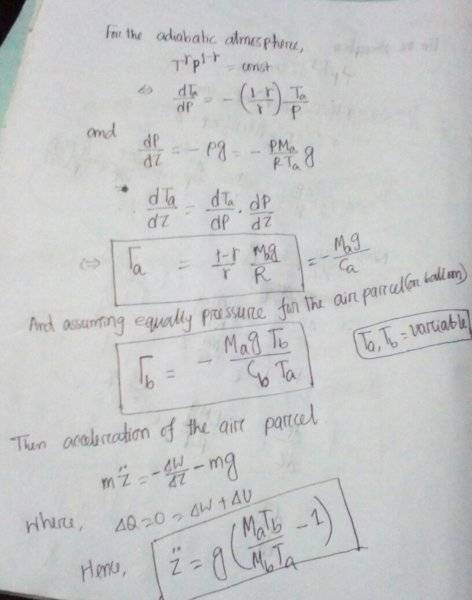

2. Homework Equations :
I first find the lapse rate ,Γ=dT/dz for both of them. And it is
Γ(a)=-M(a)g/C(a) and
Γ(b)=-M(a)gT(b)/C(b)T(a)
And z''=g((M(a)T(b)/M(b)T(a))-1)
But i couldn't find out equilibrium height equating z" to zero. Please help me to find this.
(The original problem (1st one) is posted here)

Here i don't know whether M(a) and M(b) are variable or not

@Rahan amin Make simultaneous equations and solve. Find the variable you were asking about.
Mass always is a constant wheras Weight varies with height. A variable here would specifically be the temperature of the test substances you are using.
Also equate the equations like make two equations where the unknown is a subject and write them according to L.H.S and R.H.S...
This will make other variables known to you.Last you just have to put the values and the answer is there. You might want to make a graph for the equilibrium as well. Max Height can therefore be found using extrapolation of graph.
