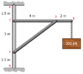

The frame is supported in pivots at A and B. Compute the horizontal reaction at A and the horizontal and vertical components of the reaction at B. Neglect the weight of the beams
How to compute it? Do I need to get the value of individual forces before I get the value of A and B?

Why all this fascination with detail, following forces through all the members ?
The particular structure shown weighs nothing and is perfectly rigid.
So step outside the box and replace the entire structure by one triangle, ABC.
Allow the problem to collapse, so you can see the solution in your head.
Or am I missing something ?

Can you visualize the function of each pivot support?
The frame and the load can rotate around the vertical axis A-B.
How are the pivots A and B stopping it from sliding down or tilting over?
