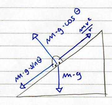

My solution is like this:
The forces acting on the car:
Normal force from the road = m g cosθ
Force down the slope = m g sin θ
Force up the slope = mv2 / r
My sketch:
My solution:
The car does not skid, therefore the force down the slope and the force away from the slope must be equal (equilibrium of forces).
The force up the slope is equal to mv2 / r since the highway is circular, and so it is the force away from the center of the circle (centrifugal force).
90 km/h * 1000m / 3600s = 25 m/s
m g sin θ = mv2 / r
==> m on both side of equation cancel out:
g sin θ = v2 / r
(9.8) sin θ = 252 / 500
(9.8) sin θ = 1.25
sin θ = 1.25 / 9.8 = 0.128
θ = arcsin(0.128) = 7.3 degrees
Is my method correct?

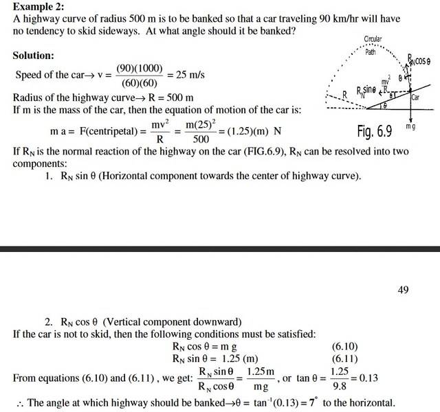

When I read the professor's solution it seems much more complicated. I didn't really understand his explanation when we did the problem in class (I'm hard of hearing and the professor is in his 80s and speaks very softly... not a good combination)
My understanding of the way the professor did it is that he placed mv2 / r as the centripetal force straight toward the center of the circle (instead of at an angle like I did) but in the end he does have the same equation that I do with (9.8) sin θ = 252 / 500.
Also, I don't understand why he does Rn cos θ = m g. I think he's considering equilibrium of the forces in both directions instead of just one direction as I did?

First of all its not centrifugal force its centripetal force
look at your fbd it is wrong. How can you write mv^2/r=mgsinθ
Is these force are in same axis?
Your method is incorrect because it is based on an incorrect free body diagram. It's OK, though unconventional, to draw it in the accelerating frame as you have. However,
1. The centrifugal force mv2/r should be directed away from the center of the horizontal circle that the mass describes. This would make it horizontal to the right.
2. You cannot assume that the normal force is N = mg cosθ. That's the case for a mass on an incline sliding up, down or at rest. Here, the presence of the centrifugal force changes its value to whatever is needed to have zero vertical acceleration. Yes, you need to apply Newton's Second Law in two dimensions.

The professor wrote Rn cosθ in the solution, is this the same as m g cosθ?
As for the horizontal forces, is it wrong that it is mv2 / r in one direction and mg sin θ in the other? Phew I'm really confused by this one :(
LuigiAM said:
Thanks for the responses..
Mg=Rncosθ

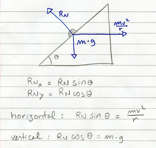

It's a pity that the solved example does not provide a free body diagram. The correct FBD, in an inertial frame, should have only two forces on the block, the weight mg straight down as you have and the reaction force Rn perpendicular to the incline. In the accelerated frame that you use, you should add the centrifugal force mv2/r in the horizontal direction to the right. This results in 3 forces, the x and y components of which must separately add to zero. Do that and see what you get.
Is this better?

LuigiAM said:
Is this better?
You can work from this diagram, or you can follow @Abishek kumar's suggestion in which case the pseudo force should not appear in the diagram, but on the other side of the equation for the horizontal components as mass times acceleration. The difference between the two treatments is that in the inertial (non-accelerated) frame the sum of the horizontal forces is Rn sinθ which is set equal to mv2/r so that you get Rn sinθ = mv2/r. (Here we assume the positive direction to the left.) In the accelerated (non-inertial) frame the acceleration is zero, but there is a negative fictitious centrifugal force to the right. The sum of all the forces is zero because the acceleration is zero. Then you get the equation Rn sinθ - mv2/r = 0. This is the same equation as the previous one except that mv2/r has shifted to the left with a change of sign. The two approaches give you the same equation, so use whichever one makes you more comfortable.

If I understand the theory then, mv2 / r is the magnitude of the centripetal force directed toward the center of the circle, but it is also the magnitude of the "fictional" centrifugal force that is directed away from the center. So it's basically a fictional reaction force that is derived using Newton's first law.
If I direct mv2 / r toward the center of the circle, then it is the centripetal force. In this case, it is not a force that is added to the horizontal component of Rn but it actually IS the horizontal component of Rn. In this case, Rnx is equal to mv2 / r. This is algebraically equivalent to what happens if you use the fictional centrifugal force mv2 / r.
Am I correct?

You are almost there. Here is the theory:
Newton's Second Law says ##\vec{F}_{net}=m\vec{a}##
This is a vector equation which means "two equations in one". The x-component of the vector on the left is the same as the x-component of the vector on the right. Likewise, the y-component of the vector on the left is the same as the y-component of the vector on the right. In other words,
##F_{net,x}=ma_x## (1a)
##F_{net,y}=ma_y## (1b)
We have to find four things, two on the left and two on the right. Let's start with the net force (left side) which is the sum of all the real forces acting on the object. Look at the drawing with the horizontal ##mv^2/r## erased because it's not a real force. We have (assuming that the positive direction is to the left)
##F_{net,x}=R_N\sin \theta##
##F_{net,y}=R_N\cos \theta -mg##
Now for the right side. We will do it in the inertial (non-accelerated) frame first. We note that the acceleration has a horizontal component towards the center (centripetal acceleration). Therefore ##a_x=v^2/r##. The vertical component is zero because the car travels in a horizontal circle, ##a_y=0##. Therefore the right sides are
##ma_x=mv^2/r##
##ma_y=0##
We now put the left and right sides together as shown in Equations (1a) and (1b) to get
##R_N\sin \theta=mv^2/r##
##R_N\cos \theta -mg=0## ##~\rightarrow~## ##R_N\cos \theta =mg##.
The rest is algebra as shown in the solution of the example.
In the accelerated frame, the vertical equation is the same, ##R_N\cos \theta -mg=0##. The horizontal equation differs in that the right side is moved over to the left side with a change of sign, ##R_N\sin \theta-mv^2/r=0##. This is interpreted to mean that, from the viewpoint of the driver who moves together with the car, the car's acceleration is zero while there is an additional horizontal force to the right that appears only if the car is turning to the left.
The result in both frames is the same, because the equations are the same.
I hope this clarifies how this is done. Incidentally, if you are wondering why your answer is close to the answer provided in the solution, it's because the correct answer is given by ##\tan \theta = 1.25/9.8## while you have ##\sin \theta = 1.25/9.8##. For small angles, less than about 10o as is the case here, ##\tan \theta \approx \sin \theta##.
