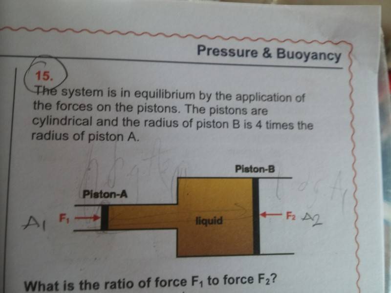

Force exerted by liquids
F=h.d.g.A
If the radius of piston B is 4 times the radius of piston A, how much larger is the area of piston B than piston A?
4 times?

phyzguy said:
No.
16?
Z3nt4r0 said:
16?
Yes, but can you explain why?
I am not quite sure so I guess not. Can you explain me how to solve the problem?
Your approach was right, you just got the areas wrong. You should go back and review how to calculate the area of a circle.
I just realized that pistons were cylindrical lol
So while piston A has an area of Pi number x r^2 piston B has an area of Pi number x 4r^2
If, for example, radius of piston a is 1, piston b's radius will be 4, making piston b's area 16 times bigger than piston a's.
So the answer to the question is 16. Am I right now?
