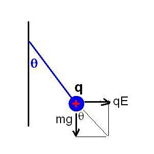

A small positively charged sphere of mass m is attached to a very large positively charged vertical plate by a string and hangs due to gravity. The charge density on the plate, σ, is uniform.
a) Calculate the equilibrium position of the ball as a function of the (uniformly distributed) charge on the ball. I.e. what angle does the string make with the vertical?
b) estimate the capacitance between the sphere and the plate.

yes, that's what the diagram looks like. and θ is the angle I'm looking for, the angle between the wall and the rope

Then wouldn't Tsinθ=Electrical force(Calculate)
and Tcosθ=Weight ?
You can eliminate tension from your equations wouldn't you?
regards
Yukoel
so electrical field is E = .5kσ/r and electrical force is F = qE so
Tsinθ = F = qE = .5qkσ/r, also Tcosθ= mg giving us T = mg/cosθ so
mgtanθ = .5qkσ/r so
θ = tan-1 (.5qkσ/rmg) but r in this case is the distance not the radius, and we want to put θ in terms of q being variable

The field due to an infinitely long sheet of charge with a given charge density σ
is given by (σ/(2ε_o))It is not a function of r.Your expression for E when revised would lend you the desired result.

I draw a picture with Paint and uploaded. It looks nicer than that made of characters :smile:
