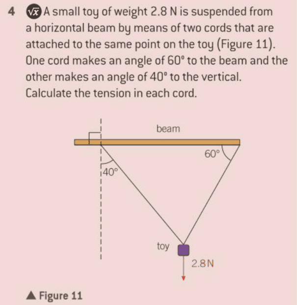

Equilibrium problem: Calculate the tension of each cord

Was practising an equilibrium problem (and i have done quite a few like this one before and got them right) and I am unsure Where i have went wrong here
t1v + t2v = 2.8
The question
What I did
The answer

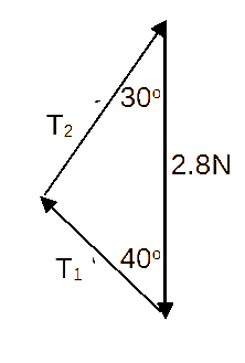

1. If you draw the force-triangle and use the sine rule, the problem takes only a few lines of simple working. (It’s a lot quicker and less error-prone than the method you used.)
2. You have forgotten the unit in your final answer - lose one mark!
Likes Lnewqban
To avoid any confusion, by 'force-triangle' (in Post #5) I meant this...
Likes erobz and BvU
