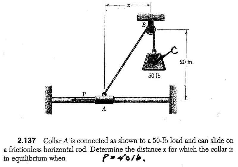

Equilibrium question with distance and weight
Would someone be able to tell me if my attempt at this is correct. It seems too easy. If it is not could you help?

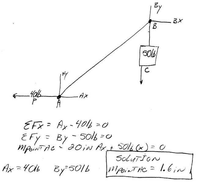

Sum of the forces in the X direction
Sum of the forces in the Y direction
Mid point = DF
attached
