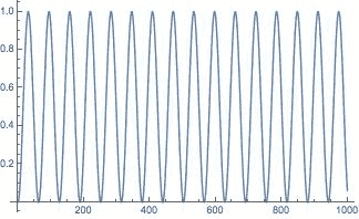

1) In first case, take a simple harmonic oscillator system as follows: mass m, spring constant k, undamped connected to another spring mass system with same mass m, same spring constant k, undamped again; and the two systems are connected via a spring with some coupling constant.
I now excite the system by giving a small displacement ## x_0 ## to the first mass, and analyze the energy of the the two systems as: ## \frac{1}{2} k x_1^2(t) + \frac{1}{2} m v_1^2(t) ## and ## \frac{1}{2} k x_2^2(t) + \frac{1}{2} m v_2^2(t) ##. The displacements and velocities calculated as per equations of motion.
Clearly the energy of the two oscillators will oscillate over time, and this is reflected in the plot of energy of the second oscillator system ## \frac{1}{2} k x_2^2(t) + \frac{1}{2} m v_2^2(t) ## attached below (Y-axis has been normalized with respect to the intial excitation energy ## \frac{1}{2} k x_0^2(t)##, and x-axis is in time units

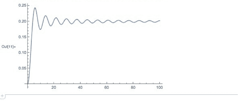

2) I now want to simulate the effect of connecting the two spring-mass systems to two heat baths which are equivalent in every way, and whose effect is to broaden the resonant frequencies of the two systems. So rather than the two systems interacting at a single resonant frequency the two systems are exchanging energy via interaction over a finite range of frequencies centered around the resonant frequency - and the energy of the two systems can be tracked by adding up contributions of all these frequencies which are interacting with one another. This dephasing results in loss in coherence in energy transfer and over time the energy in the two systems stabilizes to a certain value.
Here is the interesting part: since the two systems are symmetric/equivalent in every way - I was expecting that over time the two oscillator systems will stabilize to have equal energy between them - irrespective of the coupling strength. Note that the only asymmetry is in the initial condition (where the intial excitation energy is given to the first spring).
However, what I am noticing is different: the final energy distribution between the two oscillatory systems seems to depend on the coupling constant. A higher coupling constant will result in equal partition of energy between the two systems. But a lower coupling constant ensures that the first system will retain much of the initialization energy after a long time interval.
The plot below shows the energy of the second oscillator calculated as: ## \frac{1}{2} k x_2^2(t) + \frac{1}{2} m v_2^2(t) ## as a function of time for the weak coupling case. For stronger coupling the equilibrium is around 0.5. I believe this discrepancy has little to do with the energy stored in the coupling spring since situation is similar even if instead of plotting the energy of the oscillators, I had plotted the energy of the individual normal modes of the system using normal coordinates.

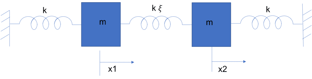

Diagram, we need a diagram. And what is a "coupling constant"?

I see no option to edit the question. (Is it possible?) So I will add the information you have requested here:
@jrmichler
##\xi## is a parameter which will decide the coupling strength of the intermediate spring. ##\xi \ll 1## suggests weak coupling
