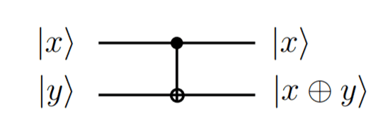

In the attached image, there are two quantum circuits that are equivalent. I am trying to understand how. Let's call the top qubit ##q_1## and the bottom one ##q_2##, and the outputs ##q_1'## and ##q_2'##. From what I understand, the C-NOT gate doesn't affect the control qubit. Because Hadamard gates are reversible, it looks to me like ##q_1'=q_1##. In the second circuit though, ##q_1'=q_1 \oplus q_2##. I also tried doing this through calculation. We'll make ##q_1=\begin{bmatrix}c_0\\c_1\end{bmatrix}## and ##q_2=\begin{bmatrix}d_0\\d_1\end{bmatrix}##. Looking at the left circuit, say the input state to the C-NOT gate is ##|\psi>## and the output state ##|\psi'>##.

You can find the matrix form of the two Hadamard gates acting on the two qubits. You can start by writing the 4x4 version of the Hadamard gate acting on a single qubit, ##H_1 \otimes I_2##.
This is what I was looking for, thanks.

The CNOT gate involves two qubits: one is left unchanged while the other is bitwise-added to the first one i.e.
OK, let us focus on the given circuit. Reading from left to right (where ## x,y \in \{ 0,1\}##) we get
\begin{align}
&\left( H \otimes H \right) \text{CNOT} \left( H \otimes H \right) |x\rangle \otimes |y\rangle \nonumber \\
&= \frac 1 2 \text{CNOT} \left( |0\rangle + (-1)^x |1\rangle \right) \otimes \left( |0\rangle + (-1)^y |1\rangle \right) \nonumber \\
&= \frac 1 2 \left( H \otimes H \right) \text{CNOT} \left( |00\rangle + (-1)^{x+y}|11\rangle + (-1)^{y}|01\rangle + (-1)^{x}|10\rangle \right) \nonumber \\
&= \frac 1 2 \left( H \otimes H \right) \left( |00\rangle + (-1)^{x+y}|10\rangle + (-1)^{y}|01\rangle + (-1)^{x}|11\rangle \right) \nonumber \\
&= \frac 1 2 \left( |++\rangle + (-1)^{x+y}|-+\rangle + (-1)^{y}|+-\rangle + (-1)^{x}|--\rangle \right) \nonumber \\
&= \frac 1 2 \Big[ |+\rangle \otimes \left( |+\rangle + (-1)^{y}|-\rangle \right) + |-\rangle \otimes \left( (-1)^{x+y}|+\rangle + (-1)^{x}|-\rangle \right)\Big] \nonumber \\
&= \frac 1 2 \Big[ |+\rangle \otimes \left( |+\rangle + (-1)^{y}|-\rangle \right) + (-1)^{x+y} |-\rangle \otimes \left( |+\rangle + (-1)^{-y}|-\rangle \right)\Big] \tag{1}\\
&= \frac 1 2 \Big[ |+\rangle \otimes \left( |+\rangle + (-1)^{y}|-\rangle \right) + (-1)^{x+y} |-\rangle \otimes \left( |+\rangle + (-1)^{y}|-\rangle \right)\Big] \tag{2}\\
&= \frac 1 2 \Big[\left( |+\rangle + (-1)^{x+y}|-\rangle \right) \otimes \left( |+\rangle + (-1)^{y}|-\rangle \right) \Big] \nonumber \\
&= \frac 1 4 \left( (1+ (-1)^{x+y})|0\rangle + (1- (-1)^{x+y})|1\rangle \right) \otimes \left( (1+ (-1)^{y})|0\rangle + (1- (-1)^{y})|1\rangle \right) \nonumber \\
&= |x \oplus y \rangle |y \rangle \nonumber
\end{align}
Where we notice that for ##(1) = (2)## to hold we need ##(-1)^{x} = (-1)^{2y + x}##. We have two cases; Case A ##x=1##: We note that ##y## is free to be either ##0## or ##1##. For any of those two values ##2y + x## will yield an odd number so ##(-1)^{x} = (-1)^{2y + x}## holds. Case B ##x=0##: We note that ##y## is again free to be either ##0## or ##1##. For any of those two values ##2y + x## will yield an even number so ##(-1)^{x} = (-1)^{2y + x}## again holds.
To show equivalence via ##2)## you will need to use the CNOT matrix representation as well as the ##4\times4## Hadamard matrix.
