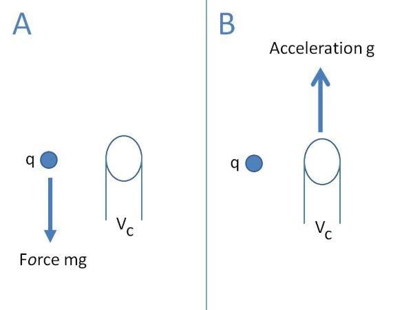

The near-range magnetic field ##\vec{B}## of a point charge ##q## at distance ##\vec{r}##, moving at a non-relativistic velocity ##\vec{v}##, is given by
$$\vec{B}=\frac{q}{4\pi\epsilon_0c^2}\frac{\vec{v}\times\hat{r}}{r^2}.$$
Faraday's law of induction for the induced EMF ##V_c## in a coil, with area ##A## and turns ##N##, due to a changing magnetic field strength ##dB/dt## through its center is given by
$$V_c=-NA\frac{dB}{dt}.$$
In scenario ##A## the charge ##q## is falling downwards due to the gravitational force ##mg## and the coil is fixed at a distance ##r## so that the induced voltage ##V_c## measured by the coil is
$$V_c = - \frac{1}{4\pi\epsilon_0c^2}\frac{N\ A\ q\ g}{r^2}.$$
But according to the equivalence principle this is exactly the same as scenario ##B## in which the charge ##q## is fixed and the coil at distance ##r## is accelerating upwards with acceleration ##g##.
In scenario ##B## is there still an induced voltage ##V_c## across the moving coil?
P.S. I think one could actually do an experiment like this but one would replace the moving charge with a moving parallel plate capacitor which would produce a dipole magnetic field.

Should we be considering the relative acceleration here? When the charge and coil are the same height, there is zero relative acceleration so I would expect zero volts across the coil.
In scenario ##A## I assume the charge is freely accelerating downwards due to the force of gravity whereas the coil is fixed to the Earth/observer (Newtonian viewpoint).
In scenario ##B## I assume the charge is at a rest whereas the coil (and the Earth/observer) is accelerating upwards (Einsteinian equivalent viewpoint).
Therefore I assume there is always a relative acceleration between them.
I think you get a voltage in the coil in both scenarios but as I understand it standard EM theory says you only get a voltage if the charge itself is accelerating.
One could argue that a falling object is not really accelerating as it does not experience proper acceleration. But it certainly looks to the observer on Earth that it is accelerating!
This common sense Newtonian view is backed up by the modern weak-field description of gravity as a standard force, acting in flat spacetime, mediated by gravitons.

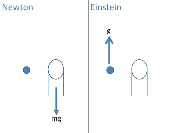

Well I guess I'm just confining my argument to the local electromagnetic interactions between the charge ##q## and the electrons in the coil. Also I'm only assuming non-relativistic velocities between the charge and coil.
I'm talking about the picture in post #1.
Let's say the q is a positive charge.
Case A: The q exerts an upwards force on the protons in the wire, downwards force on the electrons in the wire. As q exerts those forces, q feels two reaction forces that happen to cancel out.
Case B: Electrons in the wire exert an upwards force on q, protons in the wire exert a downwards force on q,
As electrons and protons exert those forces, they feel reaction forces. The voltmeter measures those forces.
Well, I hope Newtons third law applies here. "When a charge induces an electromotive force, it experiences an opposite electromotive force". If not, then all of the above is wrong.
Counter-argument in Wikipedia:
The key is to realize that the laws of electrodynamics, Maxwell's equations, hold only within an inertial frame
Source:
https://en.wikipedia.org/wiki/Parad..._a_gravitational_field#Resolution_by_Rohrlich
No, according to the following paper.
7. Free falling charges
As an immediate consequence of Larmor’s formula (5) with the application note (7), a charged particle does not radiate if it is free falling in a gravitational field, because the gravitation is exerting the same acceleration on the particle and it’s field, and hence there is no stress between the particle and it’s field. We remark ...
Source:
https://arxiv.org/pdf/1509.08757.pdf

Ok - what do think about the following formulation of my argument?
One could imagine a Newtonian scenario where the charge is at a fixed position in the gravitational field and the coil is accelerating downwards under the force of gravity.
In the equivalent Einsteinian point of view the charge is experiencing an upwards proper acceleration to keep it at a fixed position whereas the coil feels no forces in an inertial frame. According to standard EM theory the accelerating charge should induce a voltage in the coil.
Therefore in the equivalent Newtonian point of view there should also be a voltage across the coil.
What you call "Newtonian point of view" is in SR treated as an accelerated rest frame.
The answer to this question is "no". Reason:
Nevertheless, comoving observers, that is, accelerated observers with respect to whom the charge is at rest, will not detect any radiation because the radiation field is confined to a spacetime region beyond a horizon that they cannot access.
Source:
https://arxiv.org/pdf/physics/0506049.pdf
Source:
Yes but in the equivalent Einsteinian view the coil is in an inertial frame and the charge is accelerating with respect to inertial frames. Therefore I think that standard EM implies that the charge should induce a voltage in the coil in such a situation.
Also in the scenario I describe above the coil's frame and the charge's frame are not comoving which is different from the situation you describe where the observer is accelerating along with the charge.
