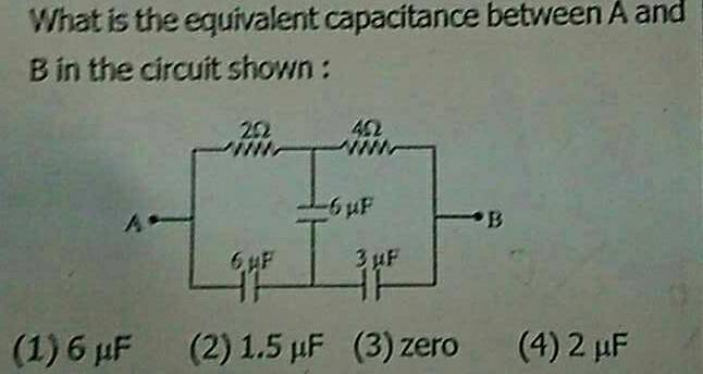

In summary, the homework statement says that there is a mistake in the circuit and that you need to find the equivalent capacitance.

I think the circuit given above is incorrect due to the presence of the two resistors . I have never seen/done a problem where equivalent capacitance is to be calculated across two points in a circuit , having resistors along with capacitors .
Is it that there is a prining mistake such that the top two resistors are actually capacitors ? If that is the case then net capacitance can be calculated .
I might be wrong .

I don't think the circuit is wrong.
You need to find the equivalent capacitance seen by a voltage source connected between points A and B.
One way to do it would be to assume some voltage VAB to find the total energy stored in the capacitors and use E=1/2CeqV2.

As I said in #2, you can assume some value for the applied voltage, say V. Then find the total energy stored, say E.
Equivalent capacitance will be Ceq=2E/V2.
This is the general method.
In this particular problem, you can see a Wheatstone bridge, so you can solve it just by inspection.

I wonder how Wheatstone bridge is present when there is a combination of resistors and capacitors .
I did nodal analysis and concluded that potential difference across the middle capacitor is 0 .
The middle capacitor can be removed .This puts the bottom two capacitors in series . Equivalent capacitance will be 2μF i.e option 4) .
I hope you are also getting option 4) .
This is same if we treat this circuit as Wheatstone bridge :smile:
How did you identify that this is a Wheatstone bridge ?
Likes Charles Link
By inspection.:wink:
You can replace capacitance C with capacitive reactance (-j/ωC) so that the bridge can be identified more easily.
If this were not a balanced bridge, you would indeed need nodal analysis and KVL to solve for capacitor voltages and total stored energy.

Any arbitrary value. It is just to see more clearly if the circuit is a balanced bridge or not.
In this case, you can see the capacitances in the lower branch and resistances in the upper branch will have the exact same voltage division making it a balanced bridge.

@Jahnavi and @cnh1995 I solved this one, but there is really a trick to it. In order to solve it, I wrote out the conservation of current/charge at the lower middle point between the 3 capacitors. I assumed for simplicity ## V_A=6 ## , ## V_B=0 ##, making the voltage ## V_C=4 ## between the two resistors. Calling the voltage ## V_D ## at the lower middle, I solved the system of equations of ## Q_1 ## ## Q_2 ##, ## Q_3 ## and ## V_D ## as unknowns. I called the charge on the middle capacitor ## Q_1 ## and the left one ## Q_2 ## and the right one ## Q_3 ##. To simplify further I left the ## \mu=10^{-6} ## off of the value for ## C ##, and called the unknowns ## x,y,z, w ##. Anyway, upon solving, ## x=Q_1=0 ##, and the rest of it could be found by substituting into the original equations. The result was then ## V_D=4 ## and ## Q_2=Q_3=12 ##. ## \\ ## By the values given to the two lower capacitors, comparing to the two upper resistors, it takes the middle capacitor out of the loop. (I didn't spot this arrangement that could be seen by inspection, so taking the long route, I found the charge on the center capacitor is zero). ## \\ ## The final result is there are two capacitors in series on the lower branch which, with the formula for two capacitors in series, results in the answer. ## \\ ## @cnh1995 I see in your post 11 that you recognized it was a balanced bridge. :)
