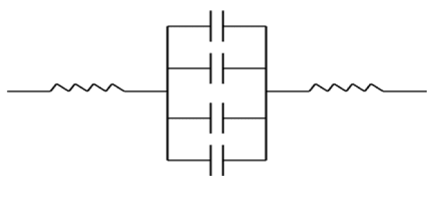

If each capacitor is filled with a dielectric material (with constant K, kappa), what is the new equivalent RC circuit? All resistors have equal value, and capacitors have equal value (without a dielectric), C.
C = (Epsilon * Area) / Distance
C with a dielectric is = KC
V=IR
Q=CV
all the resistor and capacitance equivalent equations
(Please see attached image for the RC Circuit)
I guess that it's asking for the current? Not sure what "new equivalent RC circuit" means.
I need to know what this is asking before I try it...anyone have any ideas?

I presume that they want you to find the component values for an equivalent circuit having just one resistor and one capacitor.
So just the total resistance and total capacitance?
In that case Rtot = 2R and Ctot = 4K*epsilon*area/distance
You're given the original capacitor values, C. You're not given area or distance. So express the resulting capacitance in terms of C.
Ctot = 4KC?
Sure.

Capacitors in series add up, but in parallel they actually reduce the total capacitance. The equation should be easily found in your book.
Someone please correct if I am wrong.
I was pretty sure it was the other way around...let me double check
Capacitors in parallel add directly.
I agree
