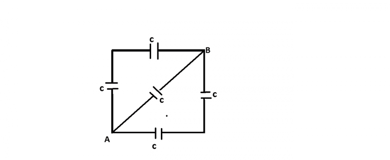

I need to find equivalent capacitance between A and B.
##C##=##C_1##+##C_2##...
It was for parallel connection.
##\frac{1}{C}##=##\frac{1}{C_1}##+##\frac{1}{C_2}##...
It was for series connection.

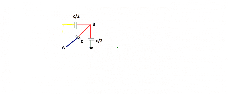

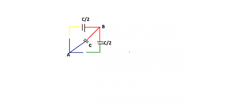

I tried to solve the problem as follows
First thing I did I used colored wire.Because i find it convenient .
Then moving forward I got the following
Am I correct till here?
Not quite. You've left gaps in the circuit wiring after replacing the series pairs with their equivalent values capacitance. When reducing a set of series capacitors you should replace all but one of them with a wire, so there are no gaps left in the wiring. You'll then want to revisit the coloring of the wiring to identify the "new" nodes.

No, you've removed wiring, not filled in the gaps left by the capacitors you've eliminated.
When you combine series capacitors they become one capacitor. You can't just leave a "hole" in the circuit for the ones that get pulled into the combined capacitance.
Note the difference:
- When parallel capacitors are combined you erase all but one.
- When series capacitors are combined you replace all but one with wires.
Likes gracy
The reduction process left the capacitors in series with only one lead connected to the circuit.
Without both leads connected a component cannot carry current. Charge cannot move onto or off of a capacitor through one wire alone. The capacitor thus has no influence, no utility, as far as the circuit is concerned. Hence equivalent capacitance become C.
Read what I said above about the difference between combining series and parallel capacitors.

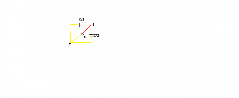

Right?We can see all three capacitors are in parallel,hence equivalent capacitance would be 2C.
gracy said:
But I am confused which wire to use?
Wire is wire... Remember, when you collapse a series of components down to one then you will be eliminating any nodes that were along the path, leaving just the two nodes at the ends where the "new" component attach. So don't expect your previous coloring scheme to survive a series reduction. Replace the wiring for the "new" capacitor with the color of the end nodes.
Likes gracy
Yes, that's good!

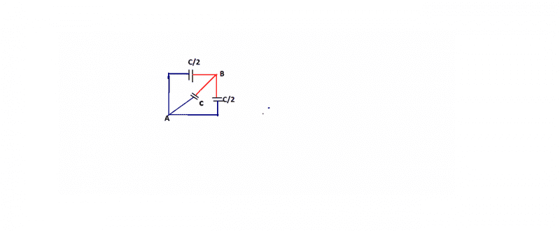

Is my image(I mean image drawn by me)in post #5 a valid circuit?I know it is not correct for this problem but does the circuit like that exist?Because I can't decide it's ending point between two ending points.
gracy said:
One last thing
Is my image(I mean image drawn by me)in post #5 a valid circuit?I know it is not correct for this problem but does the circuit like that exist?Because I can't find it's ending point.
If someone were to present it to you and ask if it was a valid circuit, the short answer would be no. A longer answer would require some context.
It is valid in that it is physically realizable. You certainly could take real components and connect them in that fashion. Whether or not it's useful is another matter. It has no voltage or current sources, and no closed paths for current to flow so it won't do anything as is. In that respect it is not a valid circuit. But you could connect it to other components, making it a sub-circuit of some other device. It's a common enough arrangement of capacitors that you will find it embedded in other circuits.

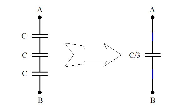

I mean in series connection we replace all the capacitors with equivalent capacitor.All capacitor's place is taken by wire but equivalent capacitor is placed in place of one of the component capacitor(here component capacitor I meant capacitors which were there in first place ;individual capacitor component of the equivalent capacitor)How will I decide which one will be that component capacitor ?
As in here
how you decided that equivalent capacitor would be in place of middle (component )capacitor?
gracy said:
As in here
You should first 'calculate' the equivalent capacitance. Here it's C/3. Then replace all the capacitors in the original diagram with a wire. Then break the wire (anywhere between A and B) and insert the equivalent capacitor.
That's what I asked!
Since there is wire elsewhere, it doesn't matter where you place the equivalent capacitor as long as it's between A and B.
