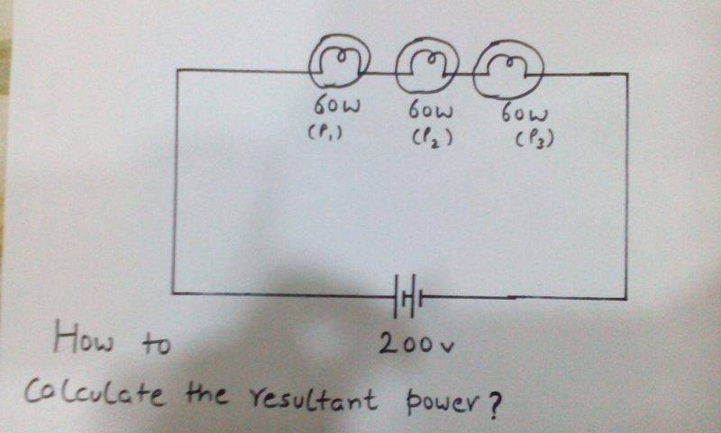

Sir, i myself have not done any math. I just seek to find a short way to calculate equivalent power in a circuit where devices of equal power rating are connected.
The source VOLTAGE is kept constant as you said.
for eg-
When three bulbs of 60W-200V rating are connected in series to a 200V supply, the power drawn by them will be : (Ans= 20W)
Now, i am asking for the proof of the formula that i have highlighted.
Have provided the circuit diagram also this time :)

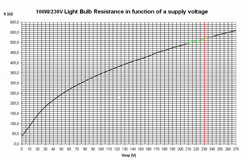

Well the answer is very simple;
If bulbs have 60W at 200V this means that the bulbs resistance is equal to:
P = V^2/R ---> R = V^2/P = 200V^2/60W = 667Ω and because we have three light bulbs connected in series the total resistance is equal to 3*667 = 2kΩ so the total power is equal to P = 200V^2/2kΩ = 20W This means that the book give you the correct equation.
But you should remember that this formula is only true for a device with a constant resistance. But this equation is not true for the light bulb. Becomes the light bulb resistance is not constant but will change with the apply voltage. See the graph of resistance of a 100W/230V light bulb in function of a supply voltages.
The resistance for 230V is equal 530Ω so current is equal 0.434A
But for 120V the current will not be equal to I = 120V/530Ω = 0.226A
As we can read form the graph the current will be equal I = 120V/ 380Ω = 0.315A

Even this answer is too simple, I think. You cannot tell, without measurement, how an individual bulb will behave. The surface temperature will surely depend upon the actual filament and envelope design and not just on its power rating. I really don't like the idea of putting filament bulbs as 'examples' of Resistors - presumably in an attempt to make the topic more approachable so the original question is 'questionable'. Science teaching is full of dodgy examples, thought up by people who don't have a lot of practical experience or detailed knowledge of the example items they include in their question.

It's halfway between a simple resistor and a real device. If you want to help someone get to the real world then your graph should be coupled with a caveat or they could take it as gospel. If you had added "one example of a 100W light bulb" I wouldn't have picked it up.
There are a whole lot of possible circuit problems that include non-Ohmic devices and they are good problem-solving fodder. Resistor/diode networks Resistor/Thermistor combinations etc etc. They all result in a nice equation to solve.
I'm all for starting simple but with the simplification being made clear.
for eg-
