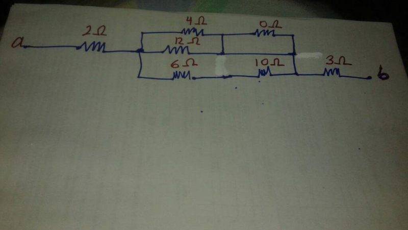

I tried to simplify the circuit by spreading it out but I guess something is wrong with my simplification since I can't arrive at the correct answer (7 ohms)...Can someone please point me in the right direction?h
You're taking the right approach, you just made a mistake. Look at the 10 Ohm resistor in the original drawing and in your first re-drawing. It is not just in series with the last 3 Ohm resistor, there is an extra connection that you left out of your re-drawing. Try doing the simplification again.

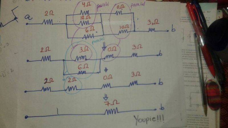

Is this better? My answer is still a little off though...
In the original image you can see there is a piece of wire parallel to the 10 ohm resistor ... :wideeyed:

Should I add a "dummy" 0 ohm resistor on that piece of wire...? Would it change anything?
The 0Ω is across the 10Ω, a parallel resistance of 0Ω.

0 ohm in parallel with 10 ohm gives an equivalent resistance of 0 ohm between the two points.

I just tried the computation with 0.0001 ohm resistor in parallel with a 10 ohm resistor and I got 0. Wow! How can that be possible? Does it mean that the 10 ohms resistor might as well not be there?
Yes.

Yes. In future you can just recognise it, and just forget any resistor in a position that is short-circuited like that, eliminate it and not include it in your calculation.
