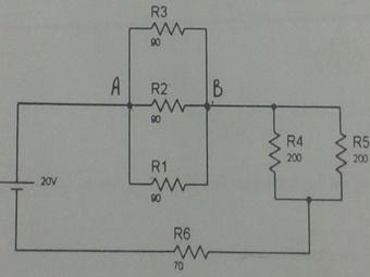

Parallel-Series resistors combinations.
Using an approach much like the one used to find the Thevinin resistance:
1- Open circuit between A and B (R1, R2, R3), and short circuit the voltage source.
2- (R4//R5)+R6=170
3- Returning R1, R2 and R3 and find their equivalent (R1//R2//R3=30).
4- Rab=170+30=200Is my approach correct? is the resistance between a and b the same as the equivalent resistance?

Was there supposed to be a problem statement or at least a circuit diagram?
Okay, the circuit diagram helps but...
What is the problem statement? What are you supposed to determine about the given circuit?
Sorry again, the question is: determine the resistance between A and B
Okay, presumably that means they want you to find the equivalent resistance that represents the combination of resistors R1, R2, and R3. In other words, the equivalent resistance of this circuit segment:
Unless there's more to the problem such as the resistors between A and B are to be taken as a load and you're to find the Thevenin equivalent for the rest of the circuit that's driving that load...

But aren't R4 and R5 also share the node B and should be considered?
Really it depends on what they mean by "between A and B". Unless they are asking for a Thevenin equivalent , I'd interpret it to mean the resistors as I've shown. It's the simplest interpretation without other information. Perhaps it's a slightly vaguely posed question, but that would be my interpretation.

Just to be sure, If A and B were:
http://i.imgur.com/Kilpty3.jpg?1
Then, the equivalent resistance between A and B would be (90//90//90)+(200//2000)=130, isn't?
Then, the equivalent resistance between A and B would be (90//90//90)+(200//200[STRIKE]0[/STRIKE])=130, isn't?
Sure. In general it's better to remove any ambiguity by indicating the intended portion of the circuit more specifically, say by drawing a circle around it. When circuits are more complex and other paths between the nodes in question are available, it's important to be able specify the intended path(s) and the excluded ones.
