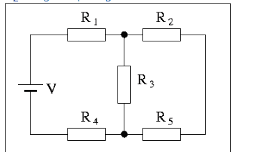

Consider the electric circuit shown in the figure. Assume that V = 13.7 V, R1 = R2 = R3 = R4 = R5 = 7.00 Ω. What is the equivalent resistance of the circuit?

I guess I'm confused as to how to 'combine' resistors to turn this into just a series circuit? I see both parallel elements and series elements.
Here's the picture.
I did try considering the circuit as a parallel circuit R1, R3, and R4 together with total resistance 21 and R2 and R5 together with total resistance 14 but that didn't work

In this circuit, it is easiest to start at the tight and fold up the resistances right-to-left.
What 2 resistors are in series on the right side? What is their combined resistance? Then what other resistor is in parallel with that combined resistance? Combine those parallel resistances. Then finally, what 3 resistances are now in series? Combine them to get the answer.
Can you try that and show us your math for each step? Thanks. :smile:
Resistors 2 and 5 form a series circuit on the right side; their combined resistance is 14. This is parallel to Resistor 3; their combined resistance is 1/R = 1/7 + 1/14 --> R = 4.66667. The three resistors now in series are 1, 4, and combined resistors of 2, 3, and 5. The sum of the resistance is 4.66667 + 7 + 7 =18.66667 ohms.
And it works!
Thank you!
