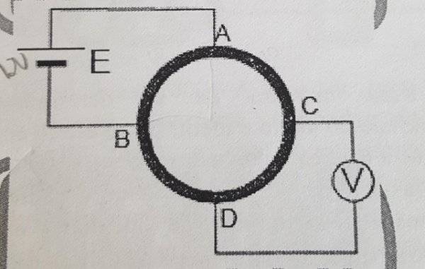

The figure shows an ideal electromotive force generator E equal to 12V, a voltmeter V, also ideal, and a graphite ring that has a constant section and a non-zero resistivity, such that a segment corresponding to an arc of pi / 2 radians has a resistance equal to 10 ohms. This ring is connected to the other elements of the circuit through four connection terminals separated angularly from pi / 2 radians. The equivalent resistance value between A and B of the graphite ring.
U=RI
R= pL / A , p = resistivity
I considered that the lengths of pi/4 and 3pi/4 would be in parallel:
1/R = 1/30 + 1/10
R = 7,5 ohm
But the answer is 30 ohm. Where am I missing and how do I calculate the potential of the voltmeter.

I agree with your answer, at least as far as the problem is stated here. Are you sure you copied it down correctly? And the connections to the ring don't change its resistance. The current that is induced depends just on the resistance of the ring in this case. If the voltmetet were replaced with a current meter, that would short out that section of the ring, but an ideal voltmeter has infinite input impedance...

Can you post an image of the whole problem? Or link to the document? Thanks. :smile:
I agree your reasoning makes sense to me. I suspect that the problem is with poor phrasing of the question.
Perhaps they meant the resistance between A-B only around the longer path. Of course, this makes no physical sense unless you cut the ring between A-B. Resistance is a property of the ring (composition, dimensions, etc.); it doesn't matter if you connect voltage or current sources, meters, etc. You may change the resistance of the total circuit, but the ring is still the ring, and it has a stable, well defined resistance between any two points.

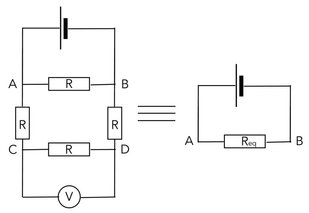

You might say something like "If you cut the ring between A and B, the resistance is 30 ohms. If you cut it anywhere else, the resistance is 10 ohms. But since the ring is complete, both paths in parallel yield an equivalent resistance of 7.5 ohms."
The natural interpretation of the question is to calculate the equivalent resistance between A and B of:
