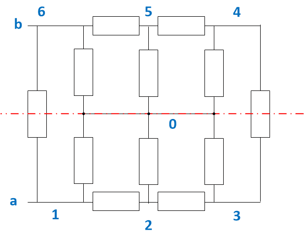

Equivalent resistance of this 6-sided circuit
  • #36
Can someone just solve this question and tell me the answer?
  • #37
Sat-P said:
Are you asking about the magnitude of the current leaving node 0 which flowed through resistor 2-0?
Yes, essentially.
More specifically:
By considering symmetry, we expect that current through one of the other three resistors (those being 3-0, 4-0, or 5-0) connected to node 0 will have the same current as the resistor 3-0 has, Furthermore, if the current through resistor 3-0 flows into node 0, the the current through the resistor in question, must flow out from node 0.
  • #38
Sat-P said:
Is current flowing through resistor 0-2 the same as the current flowing through resistor 0-5
Yes! Do you see how that follows from symmetry?
And what about the remaining radial pair, 3-0 and 0-4?
  • #39
Oh my!
I see that we've had a bit of an editing job in Post# 32 by OP.
I never saw that reference to 0-5 .

  • #41
haruspex said:
Can you be clearer? Number the nodes 1 to 6 anticlockwise around the hexagon starting with 1 at a. Call the centre 0.
A good idea ! (the naming in #1 is rather confusing)

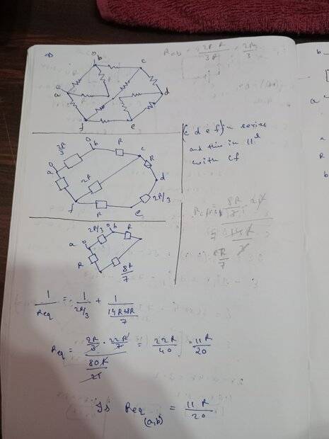

Earlier, I thought that current through resistor a0 and 0b will be the same but I was wrong, when I interpreted this mathematically I got that the current through the resistor 0b will be more than that through the resistor a0, and then I thought that current through f0 and c0 might be mirror images after passing a plain in between ab and ed, but here it is; the magnitude of current passing through them was'nt same so I couldn't just take them out, there might be another reason that the current flowing through resistor 0b has contributions of current entering from the radial resistors, so I just couldn't take this one out. Now, the current passing through resistor e0 and d0 looks symmetric, but it is not, again because of the magnitude of the current passing through it. Now, I have an idea, don't know whether it is crazy or something, but I gues if I flod the grid from cf like ab coincides ed, but I now it won't work because in the symmetry the terminals must be symmetric, so any hints what I should do next

  • #44
I am sorry for the misinterpretation, but the current through resistor 0b will be more i.e 0.65 i (approx) and current through resistor a0 is 0.334 I (approx). You can see the results in the image above. I've edited the above post.
  • #45
The image is too blurry to read with any confidence, but it looks to me that you are assuming the currents along the three resistors connected to a are equal. That's not how electricity works.
Say all the resistors are 1 Ohm and the voltages are +1 at a and -1 at b.
The voltage at 0 must be 0, so the current along ab is 2A and along a0 and 0b it is 1A.

  • #54
Once you understand the consequences of the dashed red symmetry line, you can work from right to left.

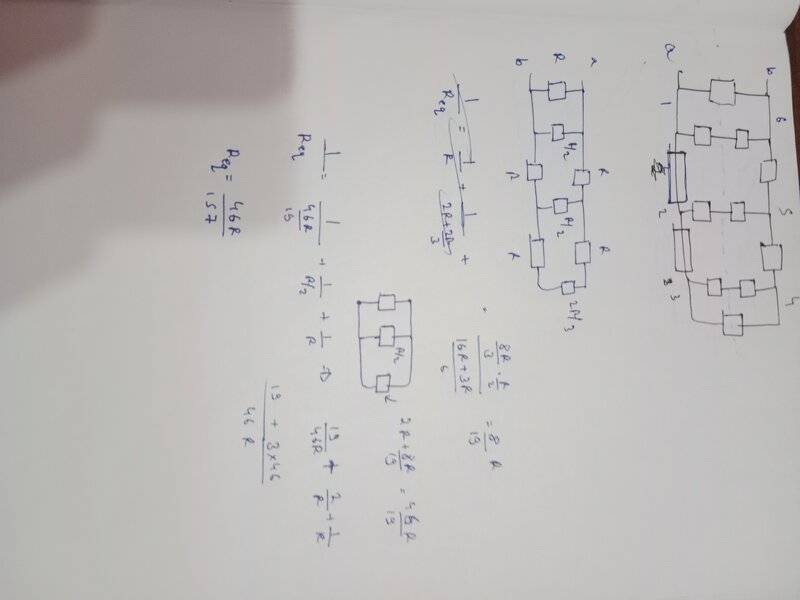

  • #55
Sir, I've tried both the methods you gave
The answers I am getting are different, please check is there something I did wrong or misinterpreted what you said
  • #56
What are we looking at ? (with a pain from craning our neck) ?
I can distinguish you replace the rightmost three with ##{2\over 3} R##, so the rightmost five give ##{8\over 3} R##. OK.
But why ##R/2## ?
  • #57
Oh, I just saw the mistake. Let me do it again
  • #58
After solving this one I got 11R/20 so is it the answer, did I do it right
Likes DaveE
  • #59
Agrees with mine, but I didn't double check.
