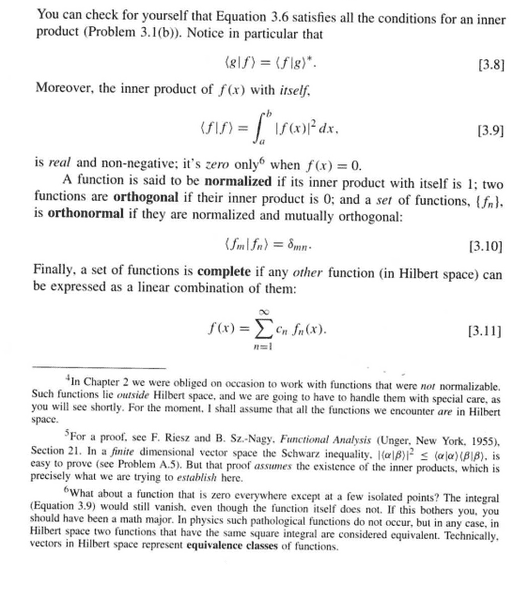

In Griffith's intro to QM it says on page 95 (in footnote 6) :
"In Hilbert space two functions that have the same square integral are considered equivalent. Technically, vectors in Hilbert space represent equivalence classes of functions."
But that means that if we take for example
f(x) = 1 | 0 < x < 1
and
g(x) = [itex]\sqrt{1/10}[/itex] | 0 < x < 10
both f(x) and g(x) have the same square integral ∫|f(x)|^2 dx = ∫|g(x)|^2 dx = 1
But how can they be considered "equivalent" - if they are wavefunctions for a particle, for example, then they represent completely different probability predictions! f(x) says you can find a particle with equal probability in [0,1], while for g(x) it's [0,10]
Either Griffith is wrong or you must have misunderstood something, but that statement is clearly untrue.

dextercioby said:
P.S. There's no footnote on page 95 of my version of Griffiths (1995, 1st edition I guess).
Here it is :
So...A vector space has to have a null vector. If L2(-inf,+inf) functions form the vector space, the only null vector is the f(x) = 0 function.
But also for any vector space, <f|f> has to be >0 for any non null vector. And yet, here
for a function like
g(x) = 1 | x=1
g(x) = 0 | everywhere else
(and other such functions)
<g|g>=0 even though clearly g is not a null vector.
So either we exclude functions like g from the vector space, or we define the vector space to be the set of equivalence classes of functions (where all functions like g would be the same class). But what is the precise formulation/definition of such an equivalence relation?
The functions are "equivalent" if they differ only on a set of Lebesgue measure 0.
(Isolated points in the domain of a function are of measure 0.)
See also:
http://en.wikipedia.org/wiki/Lebesgue_integral
http://en.wikipedia.org/wiki/Lebesgue_measure
P.S., The wording of Griffith's footnote
is wrong. But,
is ok.
The correct statement should be: f is equivalent to g if ∫|f-g|2dx = 0.
