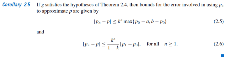

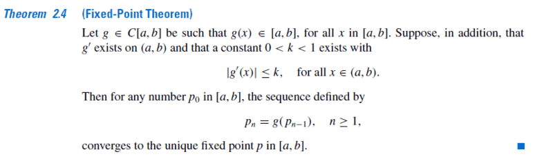

Thought I'd posted a snippet from Burden & Faires: Numerical analysis 9th ed, but perhaps it was removed by a mentor for copyright reasons ? Anyway, they follow the same thread of reasoning to prove a theorem 2.6 (using a fixed point theorem 2.4).
More important is a concluding remark there: the proof is all fine and good, bit it doesn't tell us how big ##D## is. So its practical value is minimal. That means that in real life one starts up Newton with the best available initial guess and if it doesn't converge, one retreats to a plan B to improve the starting point.

treated in the same way as in the link in #5, showing all the hypotheses in
are satisfied. Then for the error estimate
