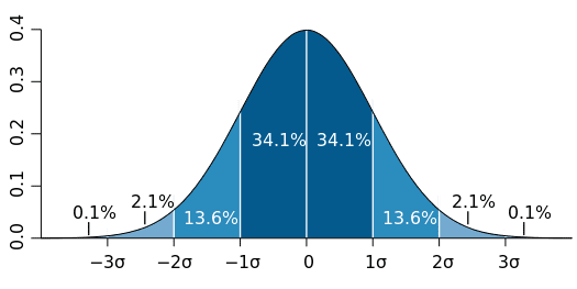

Why not ? The top of a mountain can be located pretty accurately, even if the mountain is a few km wide !
If you get a distribution like (wikipedia) you certainly can pinpoint the peak position to within a small fraction of ##\sigma## !

Thank you for your reply! I though, so, mathematically, however I am confused from a physics point of view. I know there are lots of efforts to reduce the thermal motion of atoms and molecules in experiments in order to measure their transitions frequencies. There are even specifically designed techniques meant to reduce the effect of doppler broadening (for example this). Also people are using narrow band laser to avoid broadening of the line coming from the laser itself. If one would be able to measure the central frequency even better than the natural linewidth, why would people try so hard to reduce the doppler effect, given that you can never get narrower than the natural linewidth anyway?
