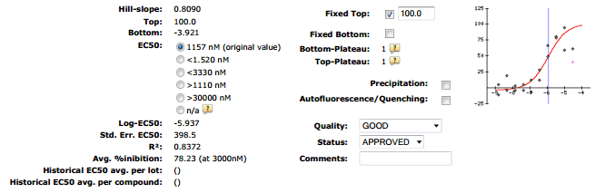

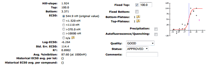

To prove what I'm saying, I pasted below two examples of dose-response curves.
The X axis is the log10 of the molar concentration (and that's usually the range that is used). The Y axis is the biological response, normalised using some standards.
You can see that for each concentration, the *same diluted solution* is added in duplicate, to two separate 'wells', that's why for each X there are two Y dots.
Do you see how far the two points in each duplicate can be? And this is even a nice case, we often see much worse!
The pink dots are those that make so little sense that the software discards them (fair enough, they are blatant outliers, probably due to precipitation or some other non-random effect). But still, the black dots can go up and down a lot.
So the software fits the Hill equation to these points, and gives to the biologist a choice (the buttons on the left) for the EC50 to assign to the molecule (EC50 is a function of K, as I explained above). The biologist tries each possibility, sees the corresponding curves (in red), and based on experience decides which curve best fits the dots.
Now, as you can see the software looks sophisticated enough, it even gives R squared, a standard error, etc.
For some reason this vital statistical information is not passed on to the chemist: from the curves below we would only get EC50=1157 for the top molecule and EC50=545 for the bottom one.
We don't have the time to go and reanalyse each curve ourselves, and besides we don't have access to the numerical data (the ones below are pictures even in the file that I can access at work).
How could we use the information from these fitting exercises to make more sense out of all this?

The graphs above are actual molecules that I'm working with, I used the word 'exercises' but I meant experiments, sorry for the confusion.
What I get in the form of numbers that I can export is: EC50, Hill slope, bottom, top (which in the examples is fixed, but in other cases can vary). We could say Rmax is top - bottom. The rest (e.g. the R squared, Std. error on EC50,..) is only shown to me as pictures, in the curves you see above. If you think any of these additional parameters can be useful to solve the problem we're talking about, I can ask IT to get those data too into the system.
