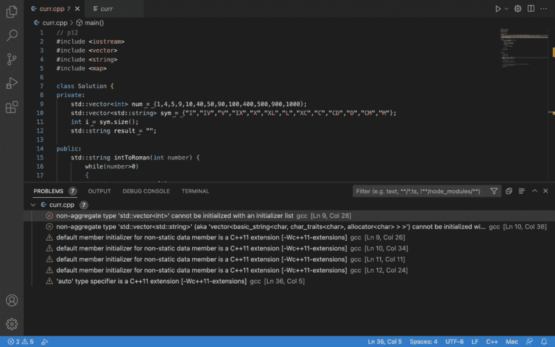

In summary: When trying to compile the following c++ code I get the errors I've screenshotIn summary, when trying to compile the following code I get the errors I've screenshot.
member 428835
C++:
// p12
#include <iostream>
#include <vector>
#include <string>
#include <map>
class Solution {
private:
    std::vector<int> num = {1,4,5,9,10,40,50,90,100,400,500,900,1000};
    std::vector<std::string> sym = {"I","IV","V","IX","X","XL","L","XC","C","CD","D","CM","M"};
    int i = sym.size();
    std::string result = "";
public:
    std::string intToRoman(int number) {
        while(number>0)
        int div = number/num[i];
        number = number%num[i];
        while(div--)
            result += sym[i];
        i--;
    return result;
int main()
    int num_ = 58;
    Solution ob1;
    auto sol = ob1.intToRoman(num_);
    std::cout << sol << "\n";
    // Solution* ptr;// = &ob1;
    // ptr = &ob1;
    // int a = ptr->intToRoman(num_);
    // std::cout << a << "\n";
    // std::shared_ptr<Solution> ptr2 = std::make_shared<Solution>();
    // int b = ptr2->intToRoman(num_);
    // std::cout << b << "\n";
    return 0;

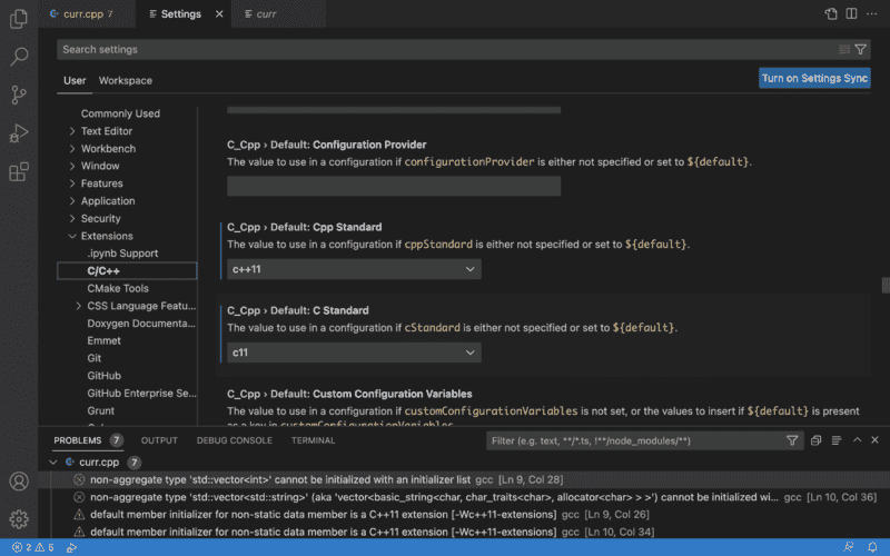

. I'm using mac VS code, and you can see I've turned on c++11. Not sure what the issue is; any suggestions?
cpp11 turned on (I think):
errors:

It looks like you are trying to initialize the vector num in line 9 using the syntax for initializing an array.
Try num{1, 4, .....,1000};
CORRECTION: It looks like C++ 11 should allow the "num = {" syntax.
At a glance your initialization look like valid C++11 to me, but considering all the warnings complaining about the code using C++11 features I would think you are not really compiling with C++11.

I get a runtime error (Debug assertion failed) when I attempted to run your code. The problem seems to be in how i is defined. The private data member i is set to 13, the number of elements in the sym vector. First off, i is a very bad choice for the name of this variable. Single-letter identifiers such as i, j, and k should be used only as loop control variables and/or as array indexes. They should not be used to denote the size of an array.
Your intToRoman() method needs to define its own index variable. I don't understand your algorithm well enough to make any suggestion, other than you probably need a loop that goes through the sym vector.
BTW, I ran your code through my VS 2017 compiler. I will probably update to VS 2022 sometime soon, but haven't done it yet.

I believe you have set the C++ standard only for VSCode's intellisense, which is for syntax highlighting and code completion while editing.
The compiler itself still uses the wrong C++ standard. You can check by inspecting the compile commands in the terminal window. It should contain something like -std=c++11 if it is set correctly. That is probably missing at the moment.

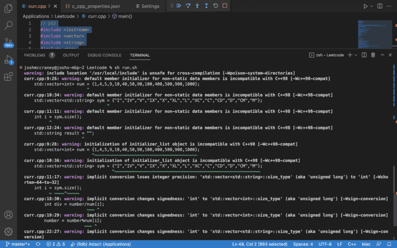

Okay, still having issues, so maybe I won't compile from VS. So I make the run.sh file which looks like this:
Code:
#! /usr/bin/env bash
g++ -std=c++11 -o ./curr ./curr.cpp
./curr

but when I execute run.sh in terminal I get the output:

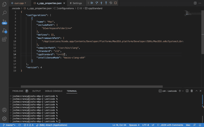

My json file is here:
The errors indicate that you are still using the wrong C++ standard.
So the command line that you intended does not seem to be executed.
How about typing the compile command in an actual linux shell and not use VSCode at all?
Also note that your shell script as it is now, will compile, and regardless of the result, will still run the executable.
If I compile your code with the command that is in your shell script, it compiles correctly without output, and I can run it, although I get a run time exception:
C++:
./curr
Floating point exception (core dumped)
If I compile it with an older standard, I get what you have:
C++:
g++ -std=c++98 -o ./curr ./curr.cpp
./curr.cpp:8:79: warning: non-static data member initializers only available with -std=c++11 or -std=gnu++11
   std::vector<int> num = {1, 4, 5, 9, 10, 40, 50, 90, 100, 400, 500, 900, 1000};

Totally missed the initial comment, sorry! But I'm STILL having issues:
I googled the first error but had no clue what to do, since results led me to -Weverything commands, which I'm not using. I thought I selected c++11, as shown. Any ideas? Thanks so much for all the help!
Nothing in the screen shot you posted is an error. These are all warnings. When the compiler reports an error, it doesn't produce an executable. With warnings, it should produce an executable, as long as you don't have the compiler configured to treat warnings as equivalent to errors. I don't have the same VS version as you are using, but I'm sure there's a way to adjust the settings for warning levels, likely under Project-><Project Name>Properties ->Configuration Properties -> C/C++ -> General. One of the options here is Warning Level, and another is Treat Warnings as Errors.
The first warning has to do with where you have told the compiler to look for include files. The warning is that for some reason the compiler deems this as an unsafe location. I'd be tempted to let that one slide.
Several more warnings have to do with how you are initializing the two vectors. I would look up how vectors should be initialized.
A couple of the warnings have to do with possible loss of precision in converting from unsigned long to int. This is caused by your use of the size operator. You could eliminate that warning by changing the type of the variable from int to unsigned long, or you could use a cast to convert to an int.
Are you able to run your program? If so, you're going to get a runtime error unless you've made the changes that are recommended in this thread.
The two config options you showed are for C11 (C/C++ config) and C++11 (C ++ standard). Most of the warnings have to do with C++98, an older standard.
