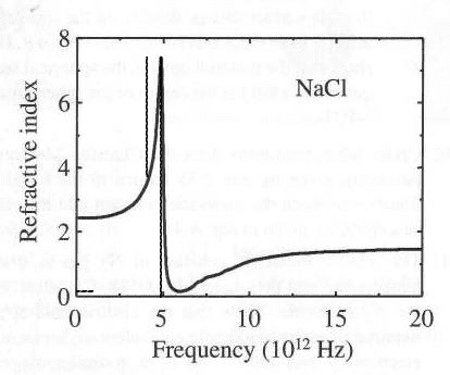

The attached plot represents a refractive index for NaCl. Resonance is caused by oscillations of dipoles Na+Cl-. Atomic numbers for Na and Cl are equal to respectively 23 and 35.5.
Estimate:
a) [itex]\varepsilon_{st}[/itex] and [itex]\varepsilon_{\infty}[/itex]
b) resonance frequency [itex]\omega_0[/itex]
c) restoring force for a unit displacement
d) concentration of NaCL molecules.
Answers: a) 5.9, 1.96 b) [itex]5\cdot 10^{12} Hz[/itex], c) 23 N, d) [itex]3\cdot 10^{28} m^{-3}[/itex]

a) I managed to obtain some results that are roughly around what is given in the answers.
Because [itex]\varepsilon_{st}[/itex] and [itex]\varepsilon_{\infty}[/itex] are values of [itex]\varepsilon_{1}[/itex], I used this approximation:
[tex]n\approx \frac{1}{\sqrt{2}} (\varepsilon_{1}+\sqrt{\varepsilon_{1}^2})^{1/2}[/tex]
-> [tex]\varepsilon_{1} = n^2[/tex]
And that gave me:
[itex]\varepsilon_{st} = 5.78[/itex]
[itex]\varepsilon_{\infty}=1.69[/itex]
I'm not sure if this is the right approach.
b) That's an easy one, I hot that right from the plot:
[itex]\omega_0 = 5 \cdot 10^{12} \ Hz[/itex]

It will help if you tell us what values you used for ##n_{st}## and ##n_{\infty}## and how you got those values. Also, it's helpful to explain the meaning of the subscripts st, ##\infty##, and ##1##.
I got these values from the attached figure: [itex]n_{st}=2.4[/itex] and [itex]n_{\infty}=1.3[/itex].

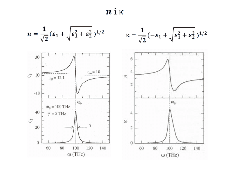

I define a complex dielectric function (permittivity) as
[tex]\widetilde{\varepsilon} = \varepsilon_1 + i \varepsilon_2[/tex]
So [itex] \varepsilon_1[/itex] is the real part of the dielectric function and [itex]\varepsilon_2[/itex] is the imaginary part.
The subscript [itex]st[/itex] comes from 'static' and it basically means that it's a value of the dielectric function for small frequencies. Analogically, [itex]\infty[/itex] means that a subscripted value is given for big frequencies.
I'm also attaching a few figures to visualize this:
OK. I think they might have used 1.4 instead of 1.3 for ##n_{\infty}##. It's hard to be precise by just reading the graph.

Using the result from the answers in c), I came to a conclusion that the reduced mass (I'm going to denote it by [itex]\mu[/itex] must be equal to [itex]\mu = 9.2 \cdot 10^{-25} \ kg[/itex] because [itex]F= kx = k\cdot 1 = \mu \omega_0^2[/itex] so we get [itex]23 = 25 \cdot 10^{-24} \cdot \mu [/itex] and that gives [itex]\mu = 9.2 \cdot 10^{-25} \ kg[/itex].
Keep in mind that ##\omega_0## is an angular frequency. The horizontal axis in the graph is frequency ##f##, not ##\omega##.

The answer in the book for part (b) is not the correct answer for the angular frequency ##\omega_0##. The answer in the book would be the correct answer for the frequency ##f_0##.
Likes mcas
That's it! Thank you so much once again.
