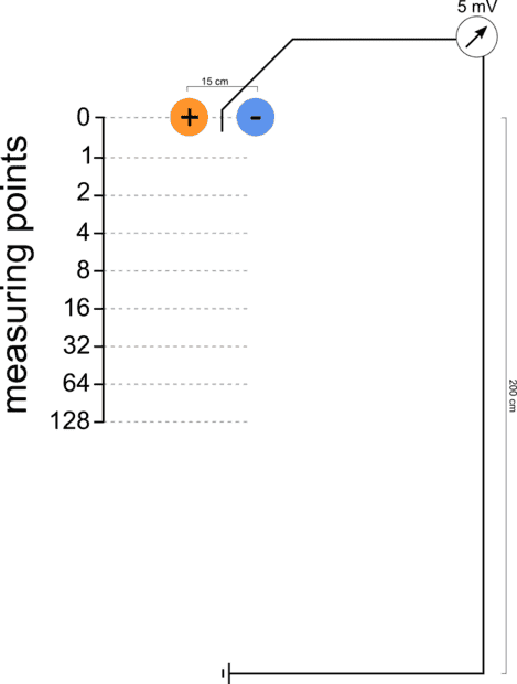

I have an underwater dipole (interpole distance is small, probably 1 cm, but cannot be estimated easily so this can only be an approximated measure) generating an electric field which voltage can be measured at 0 cm and is equal to roughly 5 mV. The reading is referred to a reference electrode placed far away at a distance of 100 cm. I would like to estimate the voltage readings at increasing distances for the values 0, 1, 2, 4, 8, 16, 32, 64,…256 cm. According to a simple decay law |E|∼W(t)/d^3 the magnitude of the electric field read at distance d should decay with the distance cube. So based on this, I have estimed these values
voltage drop (2nd column) over distance (1st column)
2 1
4 0,125
8 0,015625
16 0,001953125
32 0,000244141
64 3,05176E-05
128 3,8147E-06
256 4,76837E-07
with the first column being the distance in cm and the second the voltage in mV. However the starting point is kind of arbitrary and it starts from a reading of 2 mV. I would like to start from 5 mV and make sure I am calculating the decay properly (when does the first drop start and how? if for instance I set the first distance at 1 cm is it fair to expect a 8-fold drop already there?). I guess one way would be to resolve the field equation of the dipole at different distances (0 and 1 cm) but I wonder which equation would be correct to use. Would the following be correct

I hope this helps. I have modeled the dipole as you suggested using two point sources placed 15 cm apart. This would be "container", in reality the poles are probably much closer inside. I have placed the reference ground at 2 meters. I have a reading at distance 0 and need the other ones. The measurement does not have to be necessarily at the positive pole, they could be placed on the midline perpendicular to the dipole axis.
I have no idea what the 5mV is measuring. Unless there is some other charge around (is that a battery you have marked at the bottom?), the voltage should be zero all along the midline. It will not be zero along the measurement line you have marked.
the measurement should not be on the midline necessarily either. let's say the reading is variable around the dipole (the absolute voltage reading) but on average is around 5 mV. I would need to take that 5 and calculate the drop for increased distances. let's consider 5 mV the reading at an X position between + and -. Now I need to draw a perpendicular line passing by X and crossing the dipole axis and read voltage along the way.
It might be helpful if you described exactly what you are measuring.. I know I am confused, and believe you are also. What does "I have an underwater dipole" mean???

it means there is a dipole, underwater, it can be modeled as two point charges separated 15 cm apart. an average of 5 mV voltage can be measured in close proximity to it. The voltage will drop with distance. I need to estimate the drop. see the sketch in the previous comments.

since I do not know the actual pole distance but only the size of the container of the dipole (15 cm) I followed the suggestion to model it using a 2 point charge dipole (and I think this is accurate).

Hi @livio. Some miscellaneous points….
Is the dipole producing a constant or an oscillating electric field? From what’s been said, let’s assume it’s constant.
The potential along the ‘midline’ of a dipole is zero as shown here for example:
https://i.stack.imgur.com/0hQ6Q.png
(diagram from: https://physics.stackexchange.com/questions/339425/potential-nonsense).
Water consists of polar molecules and mobile ions (assuming you are using liquid water). Placing an electric dipole in water will cause positive charge to build up around the negative end of the dipole and vice versa. You are essentially embedding the dipole in a conducting medium, not in a simple dielectric. The usual 'simple dielectric' equations won't apply.
By the way, your description (Post #1) says that the reference point for voltage measurements is 100cm from the dipole. But your Post #13 diagram shows it much further than this.

thanks :) this is getting far too complicated than I thought.... I hope not. I think what I need is a simple equation to estimate the drop in voltage. this obviously depends on water resistivity too (this can be estimated around 5 kOhm/cm). thank you for noting the incongruency of the distance, the thing is, because the medium is water, that distance is close to "infinity" and I will not reach it with my measurements (or am I wrong on this?). I hope this helps. In any case, I do not want to stress anyone :) I will try to figure it out.
livio said:
..what I need is a simple equation to estimate the drop in voltage
But the potential is zero everwhere along the dipole's midline - see post #20. Taking V=0 at infinity, the potential does not change as you move along the midline; it remains zero. So there should be no voltage-drops. Or are you looking at points which are not on the midline?
That's only true if a current flows through the water. For static charges (which are what you apparently have) there is no current - so the resistivity of water is irrelevent here.
I think the underlying issue is that you haven't told us enough about the system or the purpose of the whole experiment. For example, what actually is the dipole - some sort of electret? Do you know the charge? Is this a real experiment requiring a large tank of water or just hypothetical?
