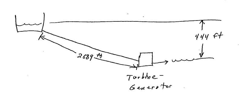

Ok, that helps a lot (ambitious project!) and the answer seems reasonable, not including any elbows or fittings you might have.
I understand that power = flow * pressure, and since I cannot increase the flow (it is limited by the stream), my focus has been on getting the maximum pressure (ie, head) at the outlet while preserving the maximum flow provided by the stream input. Basically, I've been thinking about how to design a pipe that will accelerate the water particles as much as possible without reducing their flow.
You're more or less on the right track, but pressure and flow velocity are interchangeable per Bernoulli's equation; as you increase the velocity, the pressure drops. What the Darcy equation tells you is that you should keep the velocity as low as possible for as long as possible to reduce the pressure loss. Then just before you use the water to generate power, accelerate it up to whatever inlet conditions your turbine requires.
Of course, a 10" diameter pipe has a cross sectional area of 78 inch^2, which is about twice that of the stream, so if I were to just funnel the entire stream into the pipe, the pipe would only be about half full.
That's not how you'd want it to work. The water can flow freely into the pipe at the top, but you'd regulate the output at the bottom so the pipe stays entirely full of water. You want the inlet pipe to be entirely below the surface of the stream.
Ah, ok...I think I see now. If, that is, this diagram is correct:
You only have the full 444 feet of static head if the pipe is running full AND you are measuring to the tailwater level. Your head at the turbine is the static head minus pipe friction loss.

Maximum head at the turbine is achieved with the biggest diameter pipe, smoothest pipe surface, no diameter changes, and the fewest turns, bends, and elbows. But that can also be maximum cost. So you don't want max head, you want optimum-head-per-dollar.
I'm skeptical that you will be able to calculate the optimum in advance. There are too many parameters that you would need to measure by experiment.
From what I've seen of other micro hydro projects (there are dozens of videos on Youtube), the biggest efficiency gains are not in the penstock (that's what we call the pipe for a hydro plant), but in the turbine. You'll likely want a Pelton wheel turbine and the design of the water scroll around the turbine, and the design and angle of the injection nozzles. There are many design parameters for Pelton wheels. One series of videos I viewed showed the owner making 5-10 iterative improvements in his project's efficiency. It was very instructive.
I think the best thing for you is to get in touch with other micro hydro owners, and get their advice. We know physics here, but as far as I know, none of us have done a micro hydro power project. But others, like me, might be envious of you. It sounds like a marvelous project.

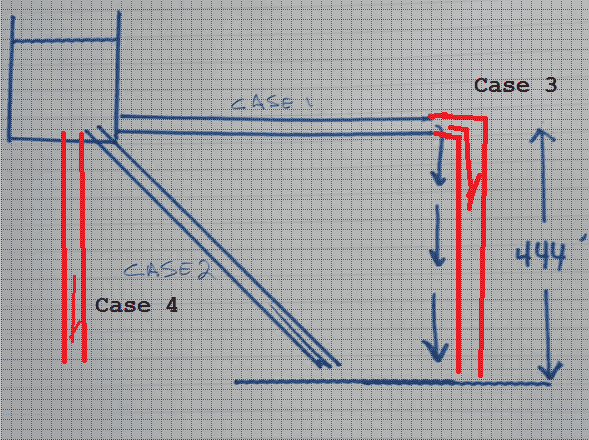

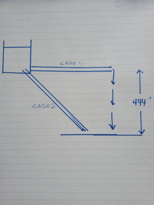

Related question: Is the static head the only driving force for flow , in diagram would the horizontal pipe and sloped pipe discharge water at same rate?
In that diagram, the static head forcing water through the horizontal pile is close to zero, so the flow rate of an uncontrolled flow would be much lower.
...unless this is some sort of trick question.
Adding two more cases for you to think about.
Case 3 is a vertical 444 foot pipe extension to Case 1
Case 4 is a vertical pipe.
Neglecting pipe friction ( ie length of pipe ) and the elbow loss, which case, 3 or 4, or 2 should have the greater flow?
Or are they all the same by Bernoulli?
Per Bernoulli, they are all the same.
Case 3 converts gravitational potential energy into pressure by stacking up a long tower of water molecules that weigh down the water column. Case 4 converts gravitational potential energy into kinetic energy by allowing the water to accelerate through open air. In theory both methods could work just as well but the friction losses will be different.
In case 4 the friction losses are due to the drag force, in case 3 the friction losses are due to the pipe walls. Both are proportional to velocity squared, but the expense of creating a horizontal pipe to setup the drop is too expensive.
If you want a pipe that follows surface of land, then you could either use the pressure method with a water filled pipe flowing as slow as possible or use the kinetic energy method by trying to get the water moving as fast as possible. however the friction in pipe would slow it down a lot and kinetic energy would not be as efficient as the pressure method. This is actually how i thought pipelines worked at first and the reason why i was initially thinking that slope should be so important in my initial post
anorlunda said:
444 feet vertical, 126 gpm, 1kw? Double check your numbers.
Yes check your numbers, I think you are off by a factor of ten.
Where are you guys seeing 1kW? I see 5 kW in post #19. That seems reasonable based on 50% extraction efficiency.
o:)
For the given conditions (126 gpm and 444 feet) I get ~10.5 kW. As @russ_watters alludes, the this would be a maximum theoretical value with real-world considerably less.
Thanks for answering, but it was mainly for @morrobay to think about in response to his question.
Likes russ_watters
Case 4 adds a vertical pipe. You are referencing case 1.
Since they are all gravity fed, the energy of the water is the same at the end of the 444 drop in elevation, barring, as I said, any friction loss in the pipes., which in the real world would have to be taken into account.
Your penstock could be of either .
A free falling column of water would be difficult to control onto the turbine buckets.
  • #31
anorlunda said:
Beware of overpressure at the turbine end. Be especially aware of what will happen if you try to turn off the flow too fast. With 2689 feet of penstock the inertia is very big and rapid shut off will destroy all your equipment. You may even need a surge pipe with a blow-out diaphragm to protect against overpressure.
This is a good point, but I'm a bit confused about how a surge tank would be made. If I'm understanding correctly, the surge tank would need to be located at the bottom of the pipeline, and would need to be higher than the head, in order to prevent water from coming out during normal operation. In other words, if I have 444 feet of head, then my surge pipe would need to be greater than 444 feet tall. Would that even work? It seems like the 444 ft of head pressure in the surge tank would prevent it from rapidly absorbing pressure spikes. I must be missing something .
Perhaps a simpler option in this case would simply be to install a pressure relief valve?
Are you serious about the dimensions? 10" diameter and 2689 feet, 444 feet vertical, 126 gpm, 1kw? Double check your numbers. What is the total mass of water in the pipe? What is the velocity of the water?
Not sure where you got 1 kw from. Some of my earlier calculations were a little bit off, but I think my current numbers below are good. I'm seeing about 10 kw power available, of which the turbine will probably capture about 80%.
One thing I notice is that the water PSI is now 176 which exceeds the 150 PSI limit for PVC (and that's without taking into account pressure surges). Therefore, I would either need to use a steel pipe, or shorten the pipeline to stay safely below 150 PSI. During actualy construction, I would need to be careful to measure the PSI and see how close reality is to theory.

  • #32
Just to be pedantic, you should know that in general pipe inside diameter is not the same as the nominal pipe size. Pipe comes in "schedules" which are different wall thicknesses. 10-inch pipe has an outer diameter of 10.750 inches. Normal or standard is schedule 40; for 10-inch sch 40 pipe the ID is 10.02 inch, transverse area is 78.86 in^2. So in this case you can get away with using 10 inch ID in your calculations.
I have never seen PVC in anything but schedule 40. You can look at the pipe manufacturer's website to see what they supply; they usually have useful tables of "Pipe Data" showing the dimensions for the various schedules in each nominal size. There is some ASME specification that defines the dimensions.
  • #33
If you have 176 psi working pressure, the burst pressure should be on the order of 800 psi. Then pressure relief valves and/or burst diaphragms should try to limit the pressure to 400 psi.
That much 10 inch steel pipe, I couldn't find the price, but at least several hundred thousand dollars.
  • #35
I see 10-inch sch 40 PVC online at about $13 per foot, so there's $35,000. Plus 150 pipe couplings, glue, supports, etc... The turbine, the controls, wiring back up to the house...
yahastu said:
our neighbor who owns property next to the road wasn't willing to give us 5 ft of easement onto a tiny corner of their 200+ acre property that we needed for the power line clearance region.
Maybe you can resume negotiations with the neighbor. Grid power at about 20 cents a kW-hr is a bargain.
