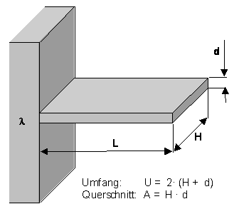

Okay, this makes sense. However I'm struggling to apply this to other examples, in particular prismatic fins.
So say a rectangular prism is extruding horizontally from a heated base plate.
The convection of the air will be flowing vertically, and the only length of the prism in the direction of this flow is the thickness of the fin (d on this diagram). So will d be the characteristic length? And if the fins where extruding the base vertically then the characteristic length will be the length of the fin? (L on this diagram).
Because this suggests that fins will be much more efficient when placed vertically as the length of a fin is usually above 10 times the thickness of it. I don't know why but to me it seems strange that it will be more efficient just by re-orientating it.
And how about if the fins are extruding horizontally but there are many fins above and below it also extruding horizontally from the base plate? In this case the air will flow up from a lower fin but then have to flow across the length of the above fin, because the air cannot just flow straight through the fin. So will you use the thickness plus the lengths of the fins? (excluding the bottom fin)
Typically, when you have multiple cooling fins, the natural convection effect is negligible, air is forced through the array of fins parallel to their surfaces. An example of this is a car radiator, where the fins are attached to the radiator tubes and act to increase the rate of cooling. The cooling fan blows air over the tube array and fins. I never heard of a practical situation like the one you describe.
