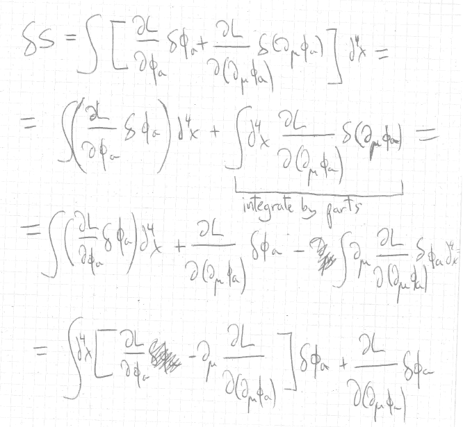

Well I know that I have to integrate by parts here. What I have done is

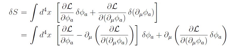

But this is not the same that what Tong got
Note that I am missing ##\partial_{\mu}## in front of the second term. But I do not see why there should be one.
Thanks.

Tong has a typo. In the second line of equation (1.5), the right square should be at the end of the line.

No, is easier than that, you must start by noticing that ##\delta (\partial_\mu \phi_a)=\partial_\mu \delta\phi_a## (actually it depends on how do you define things, but if you want all the details you must go to a more rigorous book). Then use the product rule ##\partial_\mu (ab) =a \partial_\mu b+b\partial_\mu a## and you will get equation 1.5
Until here you have not dropped anything, and there's no typo in Tong's notes (although this notation of putting the differential at the beginning confuses a little bit). It's only now, that you use divergence theorem to perform the integral
$$\int \partial_\mu\left(\frac{\partial \mathcal{L}}{\partial (\partial_\mu\phi_a)}\delta\phi_a\right)d^4x$$
And only now you can apply the boundary conditions to get Euler-Lagrange equations.

By what I see in your attempt, you are more used to do the two steps I said (product rule + divergence theorem) in a single step that you call 'integration by parts'.
Actually there is where you have your error (in the 4th equal sign), I suggest you to try to do it with the two steps I give you.

As George pointed out, there is a typo in Tong's notes.
I don't understand what you wrote here as you wrote exactly the same expression twice (apart from the overall sign). Both of them are zero (for fields obeying as usual that ##\delta \phi_a=0## at infinity).

I don't see any typo, at least in equation 1.5, what typo are you thinking about? Because in George post I understand he means that 1.5 should read as
$$\int \left[\frac{\partial \mathcal{L}}{\partial \phi_a} - \partial_\mu \left(\frac{\partial \mathcal{L}}{\partial (\partial_\mu \phi_a)}\right)\delta \phi_a + \partial_\mu \left(\frac{\partial \mathcal{L}}{\partial \partial_\mu \phi_a}\delta\phi_a\right)\right]d^4 x$$
And this of course is wrong.

Oops (for me). I still maintain that there is a typo in Tong's (1.5), but, unfortunately, my "correction" above doesn't fix the typo. You implicitly corrected Tong's typo when you wrote
In (1.5), Tong writes
$$\int d^4 x \left[\frac{\partial \mathcal{L}}{\partial \phi_a} - \partial_\mu \left(\frac{\partial \mathcal{L}}{\partial (\partial_\mu \phi_a)}\right) \right]\delta \phi_a + \partial_\mu \left(\frac{\partial \mathcal{L}}{\partial \partial_\mu \phi_a}\delta\phi_a\right) .$$
This should be written as
$$\int d^4 x \left\{ \left[\frac{\partial \mathcal{L}}{\partial \phi_a} - \partial_\mu \left(\frac{\partial \mathcal{L}}{\partial (\partial_\mu \phi_a)}\right) \right]\delta \phi_a + \partial_\mu \left(\frac{\partial \mathcal{L}}{\partial \partial_\mu \phi_a}\delta\phi_a\right) \right\} .$$
Likes JD_PM
Ah, ok I see, I don't think it is a typo, I think the writer supposes that anyone must understand that the integral goes all the way until the end (for this reason I think that putting the ##d^4 x## at the end of the integral is much better).
So yes, even if we call it typo or not, of course, we need to understand that everything is inside the integral.
OK so let us go step by step
1) Apply the product rule (i.e. ##\partial_\mu (ab) = a\partial_\mu b + b\partial_\mu a##) to ##\int d^4 x \partial_{\mu} \Big( \frac{\partial \mathcal{L}}{\partial(\partial_{\mu} \phi_a)} \delta \phi_a \Big)##$$\int d^4 x \partial_{\mu} \Big( \frac{\partial \mathcal{L}}{\partial(\partial_{\mu} \phi_a)} \delta \phi_a \Big) = \int d^4 x \Big( \partial_{\mu} \frac{\partial \mathcal{L}}{\partial(\partial_{\mu} \phi_a)} \delta \phi_a \Big) + \int d^4 x \Big( \frac{\partial \mathcal{L}}{\partial(\partial_{\mu} \phi_a)} \delta (\partial_{\mu} \phi_a) \Big)$$
But note I do not pick a minus sign. That was my point.
Ok, now, remember that your starting point is the integral
$$\int \frac{\partial \mathcal{L}}{\partial \phi_a} \delta \phi_a d^4x + \int\frac{\partial \mathcal{L}}{\partial(\partial_{\mu} \phi_a)} \delta (\partial_{\mu} \phi_a) d^4 x$$
Look that the second term in your right hand side is exactly one of the integrals you are looking for, now you can isolate this integral to get
$$\int \frac{\partial \mathcal{L}}{\partial \phi_a} \delta \phi_a d^4x +\int \partial_{\mu} \left( \frac{\partial \mathcal{L}}{\partial(\partial_{\mu} \phi_a)} \delta \phi_a \right)d^4 x - \int \partial_{\mu} \frac{\partial \mathcal{L}}{\partial(\partial_{\mu} \phi_a)} \delta \phi_a d^4 x$$
(Note how the ##-## sign appears naturally), until here, it's very similar to what you have, but in your attempt now you do
$$\int \partial_{\mu} \left( \frac{\partial \mathcal{L}}{\partial(\partial_{\mu} \phi_a)} \delta \phi_a \right)d^4 x = \frac{\partial \mathcal{L}}{\partial(\partial_{\mu} \phi_a)} \delta \phi_a$$ this is your mistake (that was a little hidden because you did all this steps at once by applying "integration by parts"). Now, forget about this last equation that is not correct, and apply the divergence theorem to the integral
$$\int \partial_{\mu} \left( \frac{\partial \mathcal{L}}{\partial(\partial_{\mu} \phi_a)} \delta \phi_a \right)d^4 x$$
NOTE: I put all the ##d^4x## at the end of the integrals to avoid any misconception like the ones we had in the discussion with George, please read that posts because they are important if you understand the notation as George and nrqed do, then there is a typo in Tong notes, and you must write 1.5 as #11.
Likes JD_PM
Ahhh thanks Gaussian97, I get it now!
