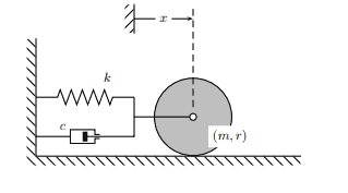

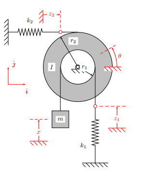

Good Morning (or afternoon)
I am in search of real-world examples of the use of Euler-Lagrange equations.
I post several examples below. These are the ones I do NOT want
You see, I think that idealized problems primarily teach problem-solving mechanics, and I take no umbrage with that; however, they can feel disconnected from real applications.
It would be nice to find a source of problems that stated that the mechanisms below are important, but not just for idealized problems. I am looking for a source that says....
"Now this problem below, is an idealiztion of a propellers, motorcycle with passenger, elevator lift, or so on. And evne provides a few words on why the particular schematic is important (beyond just practicing skills).
Does it make sense.... what I am asking for?
Like below, on the left: this is what happens when wet clothes clump up in a washing machine.
