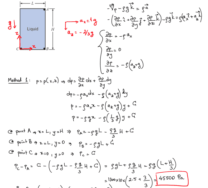

I am after PC - PA
However I must do so without breaking into components. My problem has different values
L=3
H=4
SG=1.2
downward a = 1.5g
horizontal a = 0.9g
and my coordinate is conventional positive y up and positive x to the right
cos##\theta## = 3/5
sin##\theta## = 4/5
- ##\frac {\partial} {\partial l}## (p+##\gamma##l) = ##\rho##a
- ##\nabla p## = ##\rho##a
a = 0.9g##\hat i## -1.5g##\hat j##
therefore,
- ##\frac {dp} {dl}##-##\gamma## = ##\rho##(0.9g##\hat i## -1.5g##\hat j##)
where dp = PC - PA
dl = 5 because of the 3,4,5 triangle
and in order to get rid of (i hat and j hat) i use triangle relationship and project 0.9g##\hat i## to l direction using 0.9g(3/5) and -1.5g(4/5)
therefore,
- (PA - PC) / 5 = ##\rho##(0.9g(3/5)-1.5g(4/5)) + ##\gamma##
PC - PA= -5##\rho##g(.9(3/5)-1.5(4/5)+1)
PC - PA= not correct answer

This doesn't seem to have been set up correctly. You have vectors on one side of the equations and scalars on the other. That's a no-no.
The starting equation should be:
$$-\nabla{p}-\gamma\hat{j}=\rho\hat{a}$$
To get the derivative of p in the direction from C to A, you need to dot this equation with a unit vector in that direction. What is the equation for the unit vector in the direction from C to A?
(3/5)##\hat i## + (4/5)##\hat j##

When you dot ##\nabla p## with this unit vector, you get the "directional derivative" ##\frac{\partial p}{\partial l}##, where l is measured along the diagonal from C to A. What do you get when you dot the other terms in the equation with this unit vector?
let (3/5)##\hat i## + (4/5)##\hat j## = W
where ##\gamma## = ##\rho##g
-##\frac{\partial p}{\partial l}## -##\rho##g##\hat{j}## DOT W =##\rho\hat{a}## DOT W
-##\frac{\partial p}{\partial l}## = [##\rho##g##\hat{j}## DOT W] DOT [##\rho\hat{a}## DOT W]
-##\frac{\partial p}{\partial l}## = ##\rho##g[.9##\left( \frac 3 5 \right) \hat i## - .5##\left( \frac 4 5 \right) \hat j##]

That’s not done correctly. The dot product of two vectors is a scalar.
got it,
-##\frac{\partial p}{\partial l}## = ##\rho##g(.14)
-(PA - PC) / 5 = ##\rho##g(.14)
PC - PA = 5 (1.2)(1.94)(32.2)(.14) = 52.4
So what we did here was just projecting everything along CA?
Is there another way of doing this? I saw a solution on the internet solved differently. Do you mind explaining the other solution?

fayan77 said:
got it,
Sure. What they wanted you to realize was that you can get the directional derivative by dotting the equation with a unit vector in the desired direction.
This is just basically equivalent to resolving the equation into components, to get the partial derivatives in the x and y directions. I really don't like what they've done here. The only reason this method works is that, for this particular problem, the partial derivatives of p with respect to both x and y are constant, independent of x and y.
