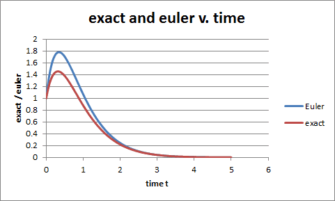

I then created an excel spreadsheet which calculate and then plots the exact solution vs. the eulerapproximation, giving me the graph:

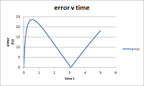

then the error graph looks as follows:
So around time t = 3, it makes sense that the error would be about 0 due to how Euler approximations work. Since Euler Approximations use the tangent lines of the functions at a certain point to approximate the shape of the graph, the more and more linear the solution gets (such as from t --> infinity in this solution), the easier it is to approximate the solution because the slope of a horizontal line is 0. However, I have absolutely no idea what could be going on here that would cause the error to start increasing seemingly linearly after time t = 3 where the solution and the euler approximation is practically horizontal. I cannot fathom that a repeated root would cause this error. Does anyone have any idea what could be causing this?
Thanks in advance.
Sorry, I thought I could be more a little more explicit about my response at the bottom. Since Euler Approximations go off of the slope of the tangent line of the exact solution and as t is increasing, the slope of the tangent line of the solution approaches 0, so the error should be approaching 0. So to answer the question, I would say that the error isn't really increasing despite what the graph displays. However, I'm not sure how to answer the part of the question asking to explicitly state what would cause it to appear as if it was increasing.

I then created an excel spreadsheet which calculate and then plots the exact solution vs. the eulerapproximation, giving me the graph: View attachment 74110

Your c1 and c2 are incorrect; you calculated y' incorrectly.
Anyway, even if you have the correct y(t) the errors can still grow (but they need not always do so). This can happen even in a simple case such as y' = a*y; see, eg., http://en.wikipedia.org/wiki/Euler_method , especially section 7. The point is that errors "accumulate", so that as the time increases you are applying a slightly incorrect step t -> t+h, starting from an incorrect y(t), and that can make y(t+h) even less correct. [Note: I said 'can', not 'will'.]
Also, I noted that your error graph is % error, or error/x, right? As x goes to zero, your small error will become very large relative to the zero value of the function. Try plotting true error to see how the method converges to the flat line at the end.
