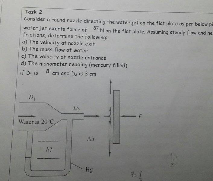

I have a diagram similar to the following. Water entering the larger end is at 20degreesC.
  1. The larger end has a diameter of 8cm and Area 50.26cm2.
  2. The small side has a diameter of 3cm and Area 7.0685cm2.
  3. The water jet exerts a force of 87N on a flat plate at an unknown distance.
  4. Assuming no frictions and a steady flow
  5. Liquid is water
Calculate the velocity at nozzle exit.

Are you currently learning about macroscopic momentum balances by any chance?
No, we have covered the Bernoulli equation, continuity of flow, the Pitot tube and the Venturi Meter.
It the smaller end open to the air?
Yes it is. I will try to update the picture of my question paper.
So, if the exit pressure is 0 Pa gauge, how do you interpret "The water jet exerts a force of 87N at the smaller end."?
I must have falsely interpreted my question. That was one of my mistakes that I am realising now. The 87 N is exerted on the flat plate which is a completely different story. I will update my question. I apologise for misinterpreting the question.

The difficulty is interpreting what they mean by "The water jet exerts a force of 87N at the smaller end." I would interpret this as the force that the flowing fluid exerts on the body of the nozzle. But, if this is the correct interpretation, then to get what you want will require using a momentum balance on the flow in addition to the Bernoulli equation.

For part (a) I don't think the Bernoulli Eq plays a role. The force on the plate is related to the rate of loss of momentum of the stream of water as it hits the plate.

The video derives the correct expression for the force on the plate in terms of ##\rho##, ##v## and the cross-sectional area ##A## of the stream.
(At the end of the video (at time 9:40), he forgot to divide the change in momentum by the time in order to express the force.)

The equation I get using a momentum balance is $$F=\rho v^2 A$$

Using this equation the velocity will be really small ! F=ρv2A
87 = 1000 * v2 *7.0685
V2 = 0.111 cm/s . Does a value of this magnetude make sense ?

v^2 = F/(density x A)
v^2 = 87/(1000 x 7.01 x10-4 )
v = 11.1 m/sMy area is in m sqaured
