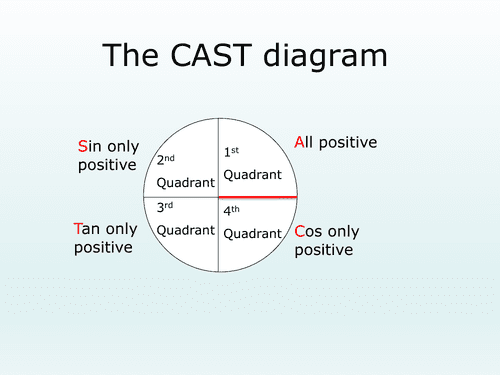

Just kidding. The question tells you that the angle is in the third quadrant, and from the unit circle you can easily determine whether each of sin/cos/tan is positive or negative in that quadrant. Some people call it a "CAST diagram":

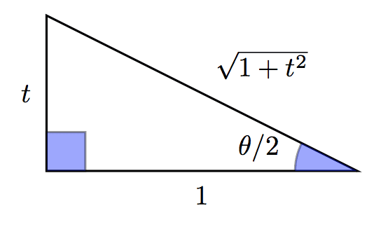

Sometimes a few right angled triangles can save you from working with lots of identities. For instance, consider the Weierstrass substituion, ##t = \tan{\frac{\theta}{2}}##:
Of course, you still need to remember some double angle formulae.
Likes PeroK

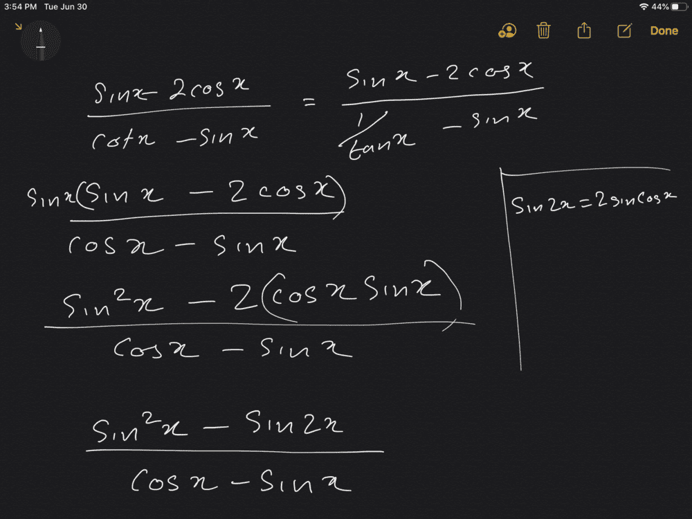

Here is what I got so far. Now where do I go from here?
lioric said:
Here is what I got so far. Now where do I go from here?View attachment 265531

In any case I can't see how the second line follows from the first. If anything, it should be ##\frac{\sin^2 x - \sin{2x}}{\cos{x} - \sin^2{x}}##, no?

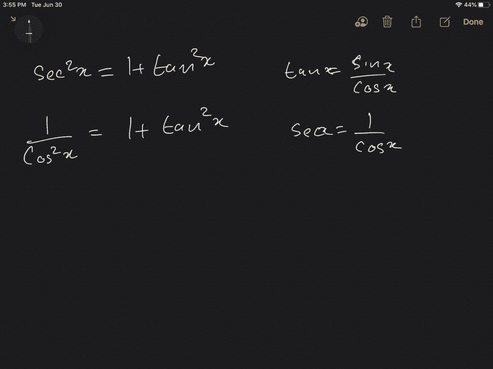

Is it really so difficult to express ##\cos x## in terms of ##\tan x##? I gave you the formula in a previous post:
PeroK said:
And ##\sec^2 x = 1 + \tan^2 x##.
How did that cos become a sin?
The cos was given in the question
  • #31
You changed $$\frac{\sin{x} - 2\cos{x}}{\cot{x}-\sin{x}}$$to$$\frac{\sin^2{x} - 2\cos{x}}{\cos{x} - \sin{x}}$$
  • #32
No, 2 cos x got multiplied by sin x to give sin 2x.

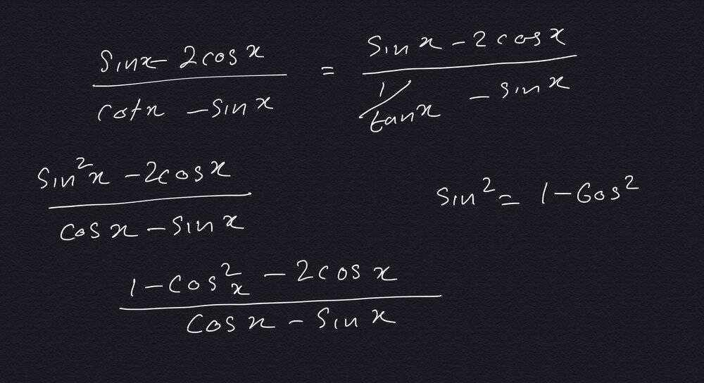

there I corrected that part
and this is cos in terms of cos
What do I do frome here
  • #34
I’m sort of stuck here.
  • #35
Your expression is still not right, since you didn't distribute the ##\sin{x}## to both terms in the denominator.
If you still want to do it the long way, you need to find ##\sin{x}## and ##\cos{x}## in terms of ##\tan{x}##. To get you started,$$\sec^2{x} = 1+\tan^2{x}$$ $$\cos^2{x} = \frac{1}{1+\tan^2{x}}$$ $$\sin^2{x} = 1- \frac{1}{1+\tan^2{x}}$$Simplify those, N.B. you need to use the quadrants to figure out the signs after you take the square root.
