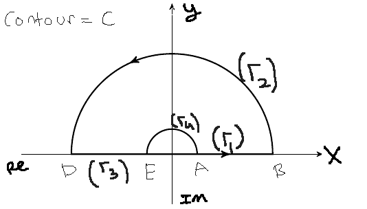

Hello,
I am evaluating:
$$\int_{0}^{\infty} \frac{\log^2(x)}{x^2 + 1} dx$$
Using the following contour:
$R$ is the big radius, $\epsilon$ is small radius (of small circle)
Question before: Which $\log$ branch is this? I asked else they said,
$$-\pi/2 \le arg(z) \le 3\pi/2$$
But in the contour it is: $0 \le \theta \le \pi$ isn't it?
The pole is:
$z = \pm i$, but the one in the contour is $z = i$
$$\text{Res}_{z = i} = \lim_{z = i} \frac{\log^2(z)}{z+i} = \frac{\log^2(i)}{2i}$$
$$\log(z) = \log|z| + iarg(z) \implies \log(i) = \pi(i)/2 \implies \log^2(i) = -\frac{\pi^2}{4}$$
$$\text{Res}_{z = i} = \lim_{z = i} \frac{\log^2(z)}{z+i} = \frac{-\pi^2}{8i}$$
$$\oint_{C} f(z)dz = (2\pi i) \cdot \frac{\pi^2}{8i} = \frac{-\pi^3}{4}$$
Evaluation of $\Gamma_1$:
$$\oint_{\Gamma_1} f(z) dz = \int_{\epsilon}^{R} \frac{\log^2(x)}{x^2 + 1} dx$$
We will take $\epsilon \to 0$ and $R \to \infty$ later down the road.
Evaluation of $\Gamma_2$:
Using $z = Re^{i\theta}$ The denominator $z$'s are there for a reason.
$$\oint_{\Gamma_2} f(z) dz = \int_{0}^{\pi} \frac{\left( \log(R) + i\theta \right )^2 iRe^{i\theta} d\theta}{z)^2 + 1} $$
$$\left | \int_{0}^{\pi} \frac{\left( \log(R) + i\theta \right )^2 iRe^{i\theta} d\theta}{(Re^{i\theta})^2 + 1} \right | \le \int_{0}^{\pi} \frac{(R)\cdot \left | \log(R) + i\theta \right |^2}{\left | (z)^2 + 1 \right |} d\theta$$
$$|\log(R) + i\theta|^2 = \log^2(R) - \theta^2 \le \log^2(R)$$
$$|z^2 + 1| \ge |z|^2 - 1 \implies |z^2 + 1| \ge R^2 - 1$$
Then:
$$\frac{1}{|z^2 + 1|} \le \frac{1}{R^2 - 1}$$
The M-L inequality states:
$$\left | \int \right | \le ML(\Gamma)$$
Estimation lemma - Wikipedia, the free encyclopedia
So $M = \max(|f(z)|)$
$$|f(z)| \le \frac{\log^2(R)}{R^2 - 1}$$
$$L(\Gamma_2) = (1/2)(2\pi R) =\pi R $$
Therefore:
$$\left | \int \right | \le \frac{\log^2(R)\cdot\pi R}{R^2 - 1}$$
$$\lim_{R \to \infty} \left | \int f(z) dz \right | \le \lim_{R \to \infty} \int |f(z) dz| \le \lim_{R \to \infty} \frac{\log^2(R)\cdot\pi R}{R^2 - 1} = 0$$
So $\displaystyle \oint_{\Gamma_2} f(z) dz = 0$
Question: But how do I find the ACTUAL max $M$?? Was that the ABSOLUTE max? The absolute max is the criteria. Help?
Evaluation of $\Gamma_3$:
$$\oint_{\Gamma_3} f(z) dz = \int_{-R}^{-\epsilon} f(x) dx$$
Again, we will take limits, $\epsilon \to 0$ and $R \to \infty$ soon.
Evaluation of $\Gamma_4$:
$$\oint_{\Gamma_4} f(z) dz = \int_{\pi}^{0} \frac{\left( \log(\epsilon) + i\theta \right)^2 i\epsilon e^{i\theta}}{(\epsilon e^{i\theta})^2 + 1} d\theta$$
$$\left | \oint_{\Gamma_4} f(z) dz \right | \le \int_{0}^{\pi} \left | \frac{\left( \log(\epsilon) + i\theta \right)^2 i\epsilon e^{i\theta}}{(\epsilon e^{i\theta})^2 + 1} \right | d\theta $$
$$( \epsilon) \cdot \int_{0}^{\pi} \left | \frac{\left( \log(\epsilon) + i\theta \right)^2}{(\epsilon e^{i\theta})^2 + 1} \right | d\theta $$
$$\left | \left ( \log(\epsilon) + i\theta \right) \right |^2 = \log^2(\epsilon) - \theta^2 \le \log^2(\epsilon) $$
$$|z^2 + 1| \ge \epsilon^2 - 1$$
$$\therefore \frac{1}{|z^2 + 1|} \le \frac{1}{\epsilon^2 - 1}$$
$$|f(z)| \le \frac{\log^2(\epsilon)}{\epsilon^2 - 1} \le M$$
$$L(\Gamma_{4}) = (1/2)(2)(\pi \epsilon) = \pi \epsilon$$
$$\therefore ML(\Gamma) = \frac{\log^2{\epsilon}\pi\epsilon}{\epsilon^2 - 1}$$
$$\left | \oint f(z) dz \right | \le \int |f(z)| dz \le \frac{\log^2(\epsilon)\pi \epsilon}{\epsilon^2 - 1}$$
$$\lim_{epsilon \to 0} \left | \oint f(z) dz \right | \le \lim_{epsilon \to 0} \int |f(z)| dz \le \lim_{epsilon \to 0} \frac{\log^2(\epsilon)\pi \epsilon}{\epsilon^2 - 1}$$So:
$$\oint_{C} = \int_{\epsilon}^{R} \frac{\log^2(x)}{x^2 + 1} dx + \int_{0}^{\pi} \frac{\left( \log(R) + i\theta \right )^2 iRe^{i\theta} d\theta}{z)^2 + 1} + \int_{-R}^{-\epsilon} \frac{\log^2(x)}{x^2 + 1} dx + \int_{\pi}^{0} \frac{\left( \log(\epsilon) + i\theta \right)^2 i\epsilon e^{i\theta}}{(\epsilon e^{i\theta})^2 + 1} d\theta$$
$$\lim{R \to \infty}_{\epsilon \to 0} \oint_{C} = \int_{0}^{\infty} \frac{\log^2(x)}{x^2 + 1} dx + \int_{0}^{\infty} \frac{\log^2(-x)}{x^2 + 1} dx = \frac{-\pi^3}{4}$$
Therefore,
$$ \int_{0}^{\infty} \frac{\log^2(x)}{x^2 + 1} dx + \int_{0}^{\infty} \frac{\log^2(-x)}{x^2 + 1} dx = \frac{-\pi^3}{4}$$
Then we use $\log(z) = \log(|z|) + iarg(z)$ to get the required integral.
Can you just check the proofs for the integrals converging to $0$?
The fact that the integral is negative should make you think that there must be something wrong somewhere... isn't it?... take into account that, solving the integral with the procedure illustrated in...
http://mathhelpboards.com/math-notes-49/integrals-natural-logarithm-5286.html
... the result should be...
$\displaystyle \int_{0}^{\infty} \frac{\ln ^{2} x}{1 + x^{2}} \ d x = \int_{0}^{1} \frac{\ln ^{2} x}{1 + x^{2}} \ d x + \int_{1}^{\infty} \frac{\ln ^{2} x}{1 + x^{2}}\ d x = \int_{1}^{\infty} \frac{\ln ^{2} x}{1 + x^{2}}\ d x + \int_{1}^{\infty} \frac{\ln ^{2} x}{1 + x^{2}}\ d x = $
$\displaystyle = 2\ \int_{1}^{\infty} \frac{\ln ^{2} x}{1 + x^{2}}\ d x = 4\ \sum_{k=0}^{\infty} \frac{(-1)^{k}}{(2 k + 1)^{3}} = \frac{\pi ^{3}}{8}$
http://d16cgiik7nzsna.cloudfront.net/82/e7/i98953090._szw380h285_.jpgMerry Christmas from Serbia

$$I = \int_{0}^{\infty} \frac{\log^2(x)}{x^2 + 1} \,dx + \int_{0}^{\infty} \frac{\log^2(-x)}{x^2 + 1} \,dx $$
$$\log(-x) = \log(x) + i\theta$$
Whatever theta is in $0 \le \theta \le \pi$$$I = \int_{0}^{\infty} \frac{\log^2(x)}{x^2 + 1} \,dx + \int_{0}^{\infty} \frac{\left( \log(x) + i\theta \right)^2}{x^2 + 1} \,dx$$
$$I = \int_{0}^{\infty} \frac{\log^2(x)}{x^2 + 1} \,dx + \int_{0}^{\infty} \frac{\log^2(x) + 2i\theta\log(x) - \theta^2}{x^2 + 1} \,dx$$
Because theta is $\pi$ for the negative x-axis and $0$ for positive x-axis.
$$I = 2\int_{0}^{\infty} \frac{\log^2(x)}{x^2 + 1} \,dx + \int_{0}^{\infty} \frac{2i\pi\log(x) - \pi^2}{x^2 + 1} \,dx$$
$$I = 2\int_{0}^{\infty} \frac{\log^2(x)}{x^2 + 1} \,dx + 0 - \pi^2 \int_{0}^{\infty} \frac{1}{x^2 + 1} dx = 2\int_{0}^{\infty} \frac{\log^2(x)}{x^2 + 1} \,dx - (\pi^3)/2 = -\pi^3/4$$
$$2I = \frac{\pi^3}{4}$$
$$I = \frac{\pi^3}{8}$$
Now that that is done, I still need a way to prove:
$$\int_{0}^{\infty} \frac{2\pi\log(x)}{x^2 + 1} dx = 0$$
With complex analysis.
We could use the substitution $t = 1/x$ then prove that $-I = I$ which implies $I=0$ but that isn't rigorous at all. The goal is
Prove:
$$\int_{0}^{\infty} \frac{\log(x)}{x^2 + 1} dx = 0$$
I don't know, well, we'll see or we can always justify $x = 1/t$ so I suppose its fine.

@Zaid, it does imply the negative x-axis.
I would rewrite it as
$$\int_{-\infty}^0 \frac{(\ln |x|+i\pi)^2}{x^2+1}\,dx = \int_{0}^\infty \frac{(\ln (x)+i\pi)^2}{x^2+1}\,dx $$
For the other integral
$$I=\int^\infty_0 \frac{\log(x)}{x^2+1}\,dx$$
You can use the same method by integrating
$$f(z)= \frac{\log(z)}{1+z^2}$$
or , simply prove that $I=-I$.
