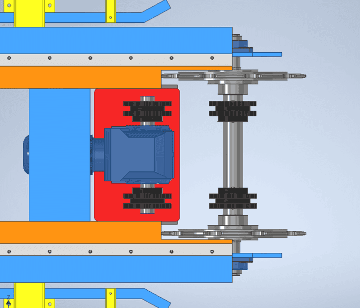

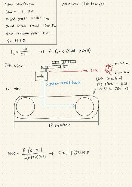

Hi everyone!
I am in a bit of a halt right now as I don't really know where to begin with this problem,
There is a chain and sprocket machine that I have the details of the motor of and majority of the dimensions of but I don't know how to start, I tried to look at some of the posts on here but I still feel a bit confused, I have attached some photos of the information I have and what I have done so far which I know is not much but hence why I wanted to come on here and ask for help,
KEEP IN MIND I am not asking for it to be solved or anything, I simply want to learn about mechanics and would appreciate some foundation on where to start from and work my way up, I have taken some courses but I don't fully know everything that needs to be taken into consideration of hence why I am glad to find this website since a lot of people seem to be very helpful
If there is any additional information required please let me know and I will get them for you since I am not sure what other dimensions might be needed,
Thanks in advance!

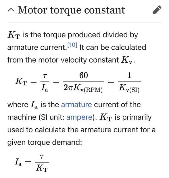

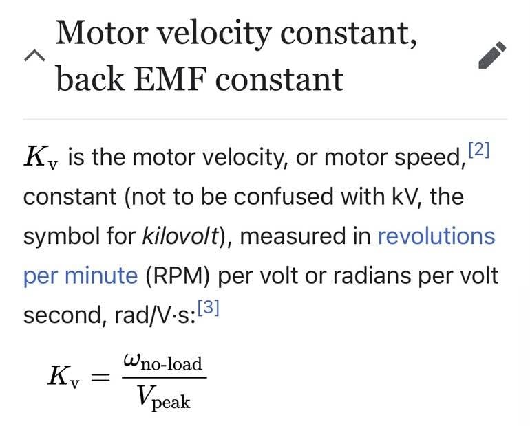

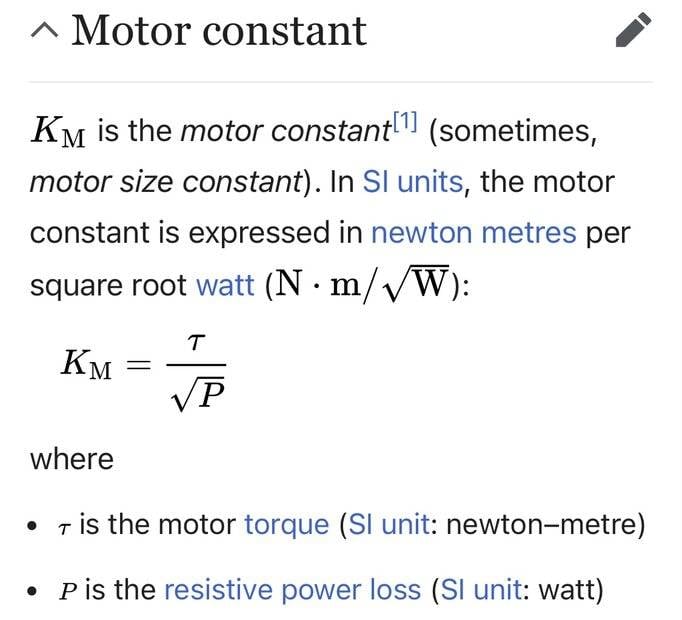

I’d personally start by determining the required KM or motor size constant which is defined as the torque per square root of resistive power loss:
https://en.m.wikipedia.org/wiki/Motor_constants
This will give you an idea of how large a motor you’ll need. In general larger motors can produce more output power for the same conversion efficiency.

Thank you so much I will definitely look into this as I didn't think about this part!
But how would I be able to apply this to my problem after I find the motor constant?

Once I had determined the necessary Km or motor size constant, I’d look at the gear ratio and input voltage the motor to determine how fast that motor needs to turn to make the machine move at the proper speed. To confirm the motor is up to the task, you’d want to look at the Kv (max unloaded rpm per volt) and Kt (torque per amp). In SI units these are the inverse of each other (higher torque per amp gives lower max unloaded rpm per volt).
Once you verify the motor is big enough for efficiency and to not overheat, and that it can turn fast enough considering your max input voltage, then its a matter of how many amps you put through the motor to get the torque you need.
A final consideration might be whether or not you can alter the gear ratio to get the motor’s operating speed close to the speed that it’s most efficient. The motor puts out the same resistive loss as it turns faster & faster at the same torque giving higher output power for the same resistive loss at high speeds, but “iron losses” start to increase rapidly as the motor turns quicker, so there is going to be a certain sweet spot rpm for motor efficiency if choosing the gear ratio is an option. Unfortunately iron losses are much more difficult to calculate than resistive losses, so determining the most efficient rpm usually requires experimentation on a dynamometer with each individual motor.

This is a machine design problem. Expanding on what @Baluncore said, the general procedure is as follows:
1) Decide what speed the conveyor needs to run -- how fast to move the panels in m/sec.
2) Calculate the RPM of the conveyor input shaft.
3) Figure out the necessary torque of the conveyor input shaft. This can be difficult to calculate because you would need to calculate the friction from every single moving part PLUS gravity effects if moving the load uphill PLUS acceleration if the panels are accelerated by the conveyor. Generally, the easiest and most accurate method is to look at the motor sizes on similar conveyors.
4) Now that you know the RPM and torque required at the motor/reducer output shaft, buy a motor/reducer rated for at least that torque and RPM at the output shaft. You want the RPM correct, and the rated torque larger than what you estimated in order to have a safety factor.
5) Hook it up and go.
This assumes that you want the conveyor to run at a particular speed. If you want to control the speed, design for the maximum speed and use speed controls to slow it down. Note that none of this requires you to know about motor constants -- just the RPM and torque.

Alright so I found the rpm to be 45.5 by doing the following
(D/19108)*rpm=conveyor speed
With D being 70 mm and the conveyor speed i'm looking for is a max of 0.166667 (or 10 meters per minute)
I just have a question, does that mean that the rpm of the motor (where I attached the specifications for above) is before the gearbox reduces it?
So if the final output rpm is 45.5rpm, and you have a 137:1 gear reduction between the motor and final output, then the motor spins 45.5 * 137 = 6233rpm
An AC induction motor, without a speed controller, should have a maximum possible speed of; (supply_Hz * 60) = 3600 RPM.
I suspect there is a factor of π or 2 missing somewhere.
If the motor has magnets and a DC power supply (BLDC motor) you would look at the motor’s Kv constant (max unloaded rpm per volt) If your DC power supply is 100v, then a 65-70Kv motor should work. If the DC supply is 48v, then you’d need a 6500rpm / 48v = 135kv or higher motor.
The Kv of the motor depends on how many turns of copper are wrapped around each stator pole in the motor. It could be wound with less turns of thicker wire or more turns of thinner wire. Less turns of thicker wire gives higher KV. More turns of thinner wire gives lower KV, but since KT (torque per amp) is the inverse of KV in SI units, more turns gives more torque per motor amp. I say “motor amp” because the speed controller does a voltage change between the input dc voltage and the voltage sent to the motor via altering the duty cycle, and so you will generally have more amps running through the motor than being drawn from the DC supply, because the speed controller reduces the “effective” voltage sent to the motor to control the speed.

That's the same that I get assuming 10 meters per minute and a 70 mm diameter conveyor drive roll. The next step is:
Another way to get the drive torque is to place the maximum load on the conveyor, wrap a long string around the drive roll, and pull the string using a spring scale. From the force to move the conveyor belt, and the radius of the drive roll (35 mm), you calculate the drive torque. Multiply the measured drive torque by a safety factor of 2 to 3 to get the design drive torque.
Now calculate the power to run the conveyor from the design drive torque and RPM (45.5 RPM). After the torque and power are well understood, then we can start to size the motor and reducer.

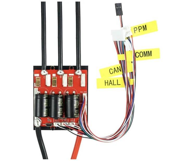

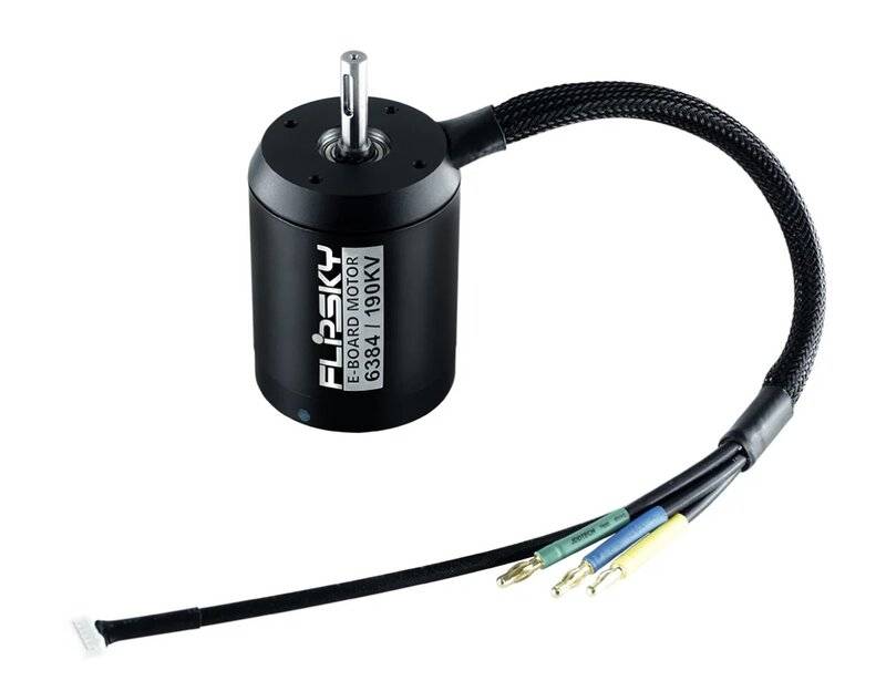

It says your power requirement is 1.1kW
This motor seems to fit the bill (would require 48v DC power supply and Electronic speed controller:
https://flipsky.net/collections/e-s...ened-6384-190kv-4000w-for-electric-skateboard
Motor $119USD
48v x 140kv gives up to 6700rpm
Rated Up to 4000w (4kW)
Electronic Speed Controller $121USD:
https://flipsky.net/collections/ele...e-on-vesc6-6-with-aluminum-anodized-heat-sink
2000W 110-240AC to 48v DC Power Supply $259:
https://www.amazon.com/JINGMAIDA-Sw...uter-Project/dp/B08SQ5Z8VN/?tag=pfamazon01-20

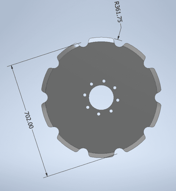

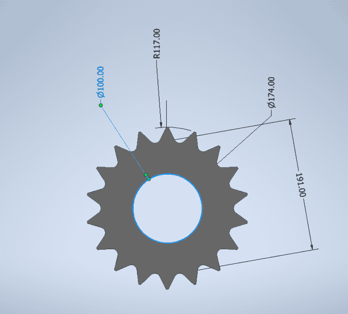

oho11 said:
With D being 70 mm
Are you sure this part’s diameter is 70mm (2.76in) and not 70cm (27.5in or 2.2ft)?
  • #31
Sorry I forgot to mention that I got the 70 mm from the shaft coming out the motor, the one you have shown is the sprocket that moves the conveyor belt, I did this because @jrmichler mentioned to measure the rpm coming OUT the motor

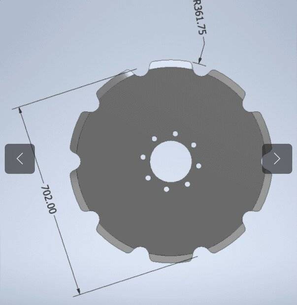

If the sprocket that moves the conveyor is 702mm this changes everything.
  • #34
I have shows how the system goes from the motor, to a sprocket moving another sprocket with the same amount of teeth, which moves that bigger sprocket. I just want to know if the motor I have specified is enough for my use, if not I will need a bigger motor obviously.
The reason for my post is that I don't really understand how torques and forces are transferred in a sprocket system, when you say it changes everything what do you mean exactly?
