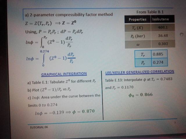

I was revising the topic on the evaluation of fugacity of liquids and gases for my chemical engineering course, when I ran into an equation which I think, may be wrong as I think it may evaluate to ln0, which is infinity.
Here is a snapshot of the equation:
The equation in question is the integral just above the words "GRAPHICAL INTEGRATION".
May I know if the equation is erroneous?
Thanks!

Have you looked through your textbook? It would be in Chapter 11 of Smith, Van Ness, and Abbott if I am not mistaken
Hi Maylis. I think my friend got his answer already~ :) He said something about using the table, and that the Z thingy is a function of Pr. Haha. Is he correct? I don't have the textbook, perhaps I can ask him to borrow it at the library. :)
He may be speaking about the Lee-Kesler correlations, which are found in tables in the same textbook mentioned. Those tables require the use of double interpolation, so be methodical when using them to find the compressibility factor, Z.
I see. Yupp, my friend said he has understood the concept. :) Thanks!
