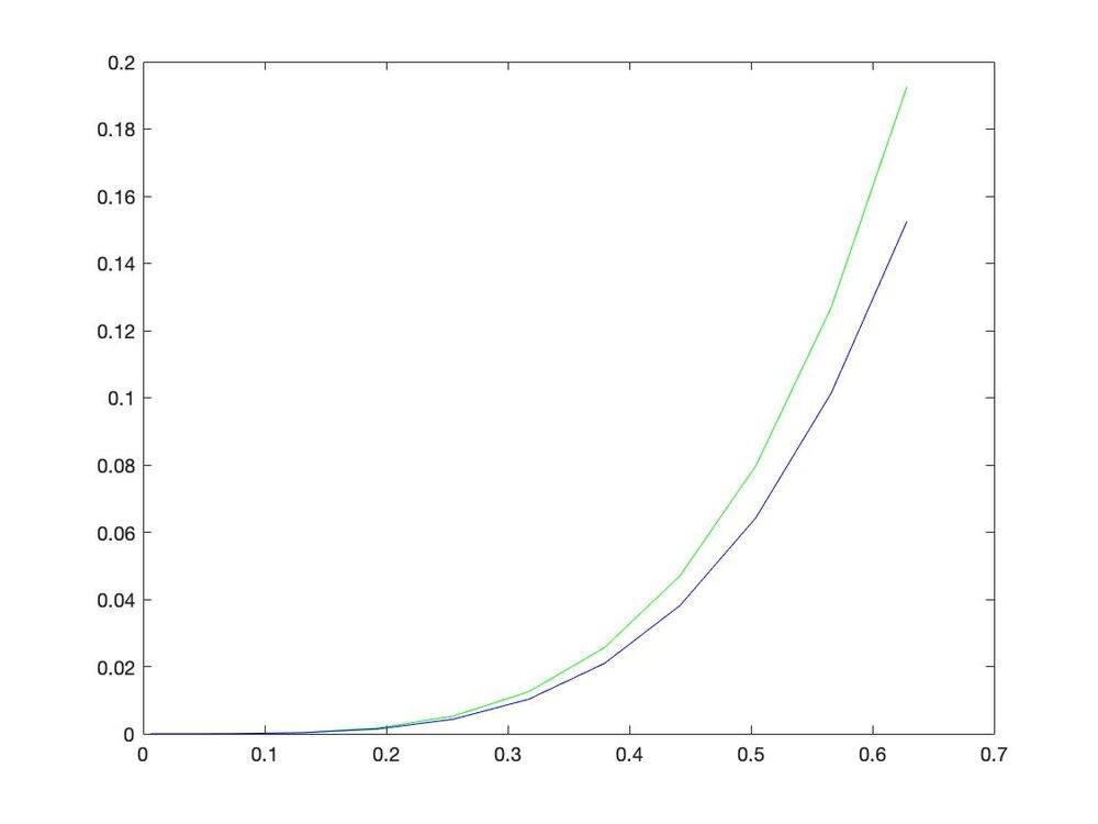

In summary, the far field accepted formula and my numerical program that is supposed to be general match closely. I find that power is up to 10% higher in the near field when I graph it through a surrounding cube.
PhDeezNutz
721
464
This is not so much a homework question but a conceptual one. I have written a numerical program for the Vectorial Kirchhoff Integral which relates incident fields to the diffracted fields (see relevant equations). I want to treat the case of a circular aperture of radius where the aperture radius ##(a\gg \lambda)## where ##lambda## is the incident wavelength. I have created flux patterns that corroborate known formulas in both the far and near field. I have then integrated to find total flux through cubes of varying sizes (all the way from the far field to the near field) surrounding the aperture. I was hoping for power conservation and that is what I got for most part EXCEPT for in the near field I'm getting what looks like an initial evanescent wave. Is this correct? I'm finding papers that talk about initial evanescent waves in the near field for sub-wavelength apertures but not for supra-wavelength apertures (the case I am specifically treating).

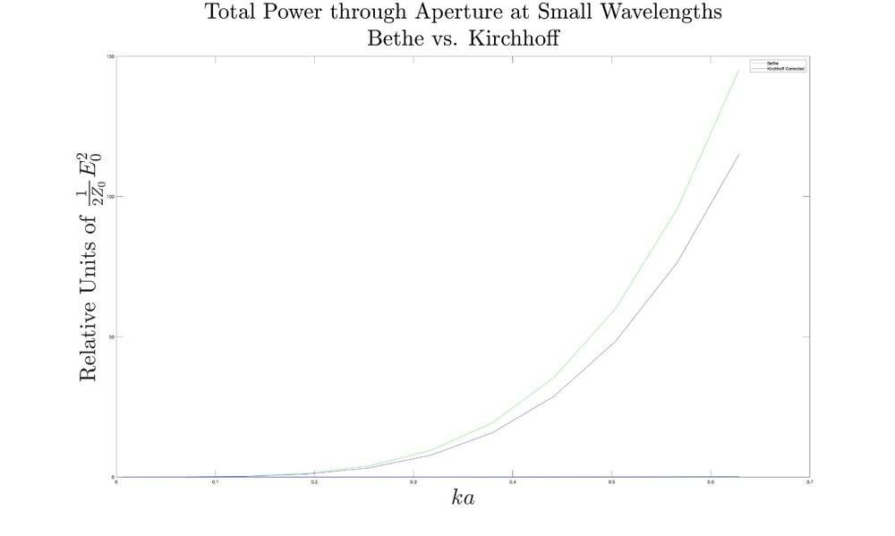

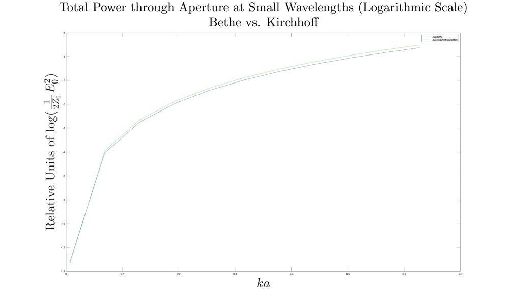

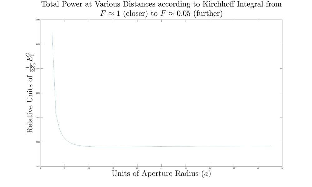

After numerically evaluating the above integrals (in Cartesian because that is ultimately what a computer uses) I can calculate the time averaged Poynting vector numerically ##\vec{S} = \frac{1}{2} \text{Re} \left( \vec{E} \times \vec{H}^*\right)## with little difficulty.
In the near field we have (using scalar diffraction theory so this might look weird)
##E_z \left( \vec{r} \right) = \frac{E_0}{i \lambda} \int_{aperture} \frac{e^{ikr}}{r} \frac{z}{r} \, da'##
##S_z = \frac{1}{2 Z_0} \left| E_z \right|^2 ##

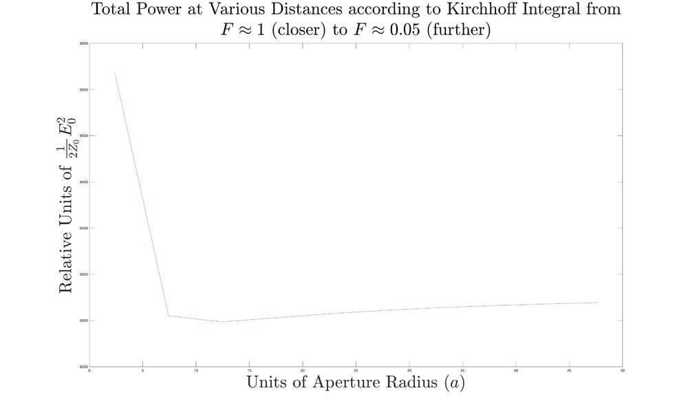

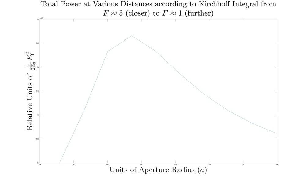

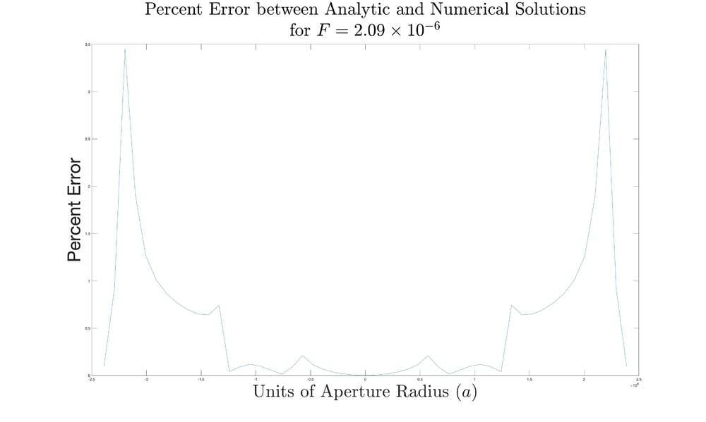

We have two different accepted formulas for the far field and near field respectively. I want a numerical program that works for both, furthermore I want to use it to calculate power through the aperture after confirming it in the far field vs near field.

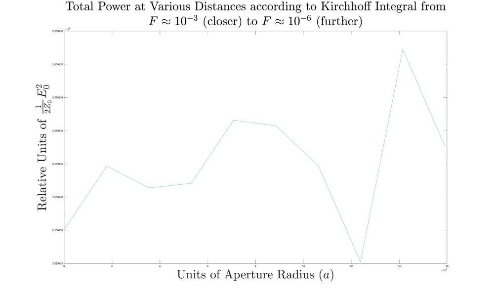

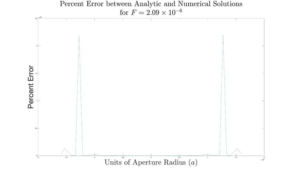

I start off by treating the far field first ,where Fresnel Number ##F \ll 1##, because that is what most people think of when they think about diffraction. Because the Kirchhoff Integral produces cylindrically symmetric z-flux patterns I will post cross sectional slices.
Far Field accepted formula
Far Field Numerical
Near Field Accepted Numerical
Near Field Numerical 2 (My numerical program that is supposed to be general)
As we can see there is a strong correspondence amongst the accepted formula and my numerical formulas.Now when I graph power flux through various cubes surrounding the aperture
I get substantially up to 10% more power in the near field
My question is:
Should this be expected in the supra-wavelength diffracting limit? I know that in the sub-wavelength diffracting limit there are initial evanescent waves
https://www.osapublishing.org/ao/abstract.cfm?uri=ao-34-17-3055
What about in the supra-wavelength diffracting limit?
Edit: My units on the vertical axis of the last graph are wrong. They should have units of Poynting Vector times area not just Poynting vector. I have to think of a good way to normalize this.

Also, could you use more sample points in your graphs? There seems to be a lot going on that's under sampled.
Likes PhDeezNutz
Paul Colby said:
Another kind of physical way to see that all k values in the plane are needed is to imagine the currents induced in modeled surface, such as a grating. Large in plane k components are required to meet the boundary conditions at the surface were high spatial frequency features are present.
I am not quite at that level yet but it's definitely something I will keep in mind as I learn more. Does my last "proof" seem agreeable to you? Aside from the mistakes like ##U \left( k_x x, k_y y, etc\right)## should actually be ##U \left(k_x, k_y, etc \right)## which I will edit and fix now.
I should do that. The problem is that each of those points was generated by brute force integration and I wanted to do it over a wide range of Fresnel Numbers without my computer taking forever to do it. In order to sample more points I will have to Isolate the near from far field.
But that's definitely something I should do and will do. I'll work on that today and post the results.
I've spent a lifetime optimizing such calculations. In the end I would settle for the right answer.
