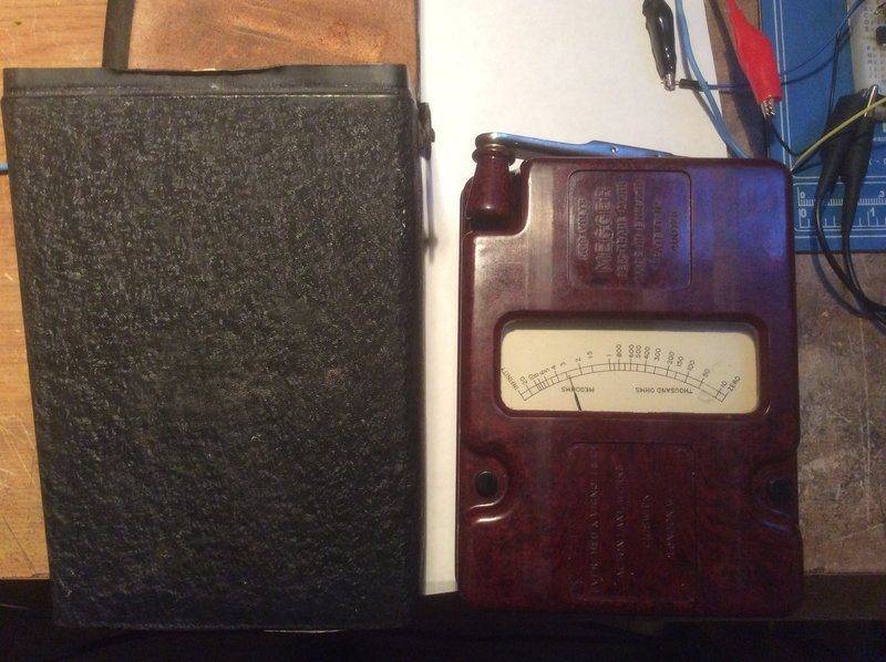

I saw this beautiful old machine on eBay, and couldn't resist it. Comes in a brass case with carry handle, and is encased in walnut-effect Bakelite. The screws and terminals are solid brass, and it actually smells of pipe tobacco.
I have tested it, and wonder if anyone can verify it really is working correctly:

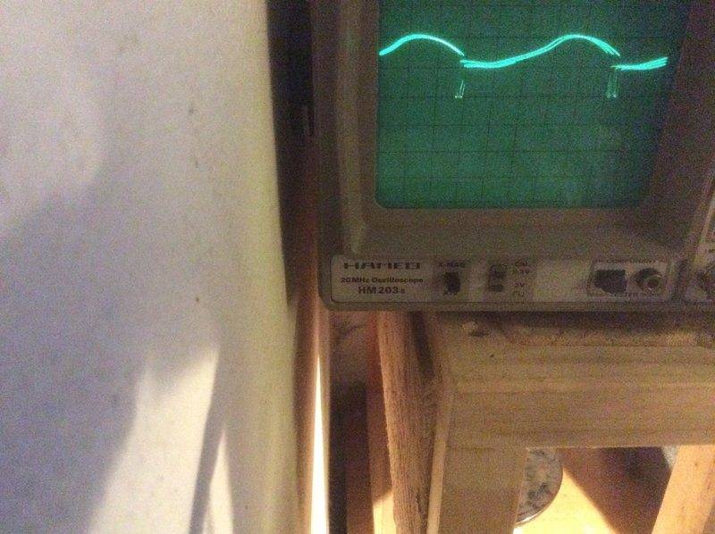

Open circuit voltage, crank speed 120 rpm: 400-420V. However, if I do 1ns peak detect, the voltage max is 561.5V. Needle reads very close to, but not quite, infinity.
Short circuit current: 6 mA DC. Needle reads dead-on 0 ohms.
Attaching resistors across output from 10K to 10M results in a reliably accurate reading.
Scope shot:
2ms/div.
20V/div x10.
DC coupled.
Sorry for the wobbly shot - it's hard to capture while cranking!
Do you think it's 'calibrated' and working OK? I'd rather not open it, as the original lead metal plugs are still present, with a maker's stamp, suggested it's not been opened since manufacture, approx 1940. If there is a fault then I'll open it for service.
Serial number is 282427.

I think, because of the limited current, that the voltage will simply drop lower the lower the resistance. I have, of course, grabbed onto the leads and cranked it to see what it's like - unpleasant.
The movement is very interesting - the needle is not biased, and when not reading it just flops around. Internally, on the moving part, there's a current coil and voltage coil, set perpendicular to each other and wound in opposite directions. A permanent magnet sets up a field across these. When cranking/measuring, the mechanism appears to compare voltage and current:
1. Open circuit = high V, low I. Reads infinity.
2. Shorted = low V, high I. Reads 0.
The resistance reading seems to result from the vector sum of the opposing influences of the current and voltage coils.
Based on your short circuit current, we could estimate a Thévenin Equivalent circuit of 420V voltage source, in series with a 70 kΩ resistor.
With skin resistance of say around 100 kΩ, this gives around 2.5 mA current if you are holding it. Considering that it is sort of an AC waveform, that would feel worse than equivalent DC voltage.

No calibration needed. No batteries to go flat. More strength to your arm. They are an excellent instrument.
I have several scattered around here. Meggers come in different insulation voltage ratings, usually 500V or 1000V. The voltage is often printed on the scale, but yours appears to be 500V, cast into the Bakelite case.
For the principle of operation see; http://www.richardsradios.co.uk/megger.html
The meter needle has no control spring for setting zero calibration, so it appears to be faulty and usually settles wherever. That can reduce the price when you find one. I was at an Electricity Authority disposal sale looking at two with high price tags on them. I picked one up, when another purchaser demanded immediately to buy the one I was holding. I told him OK, and handed it to him, pointing out that the meter was “drifting”, so he grabbed the other, “it's the same” I said. After the offensive customer left, the store keeper who had been watching, sold me the two for $5, I kept one and gave the other away.
I also picked up a very nice 1000V E&V Bridge Megger from the same Authority. It is the same as is shown here; http://www.richardsradios.co.uk/brmegger.html
I checked the calibration, but have never needed the 4 digit precision of it's manganin wire wound resistors, but the 1000V insulation tester gets used.

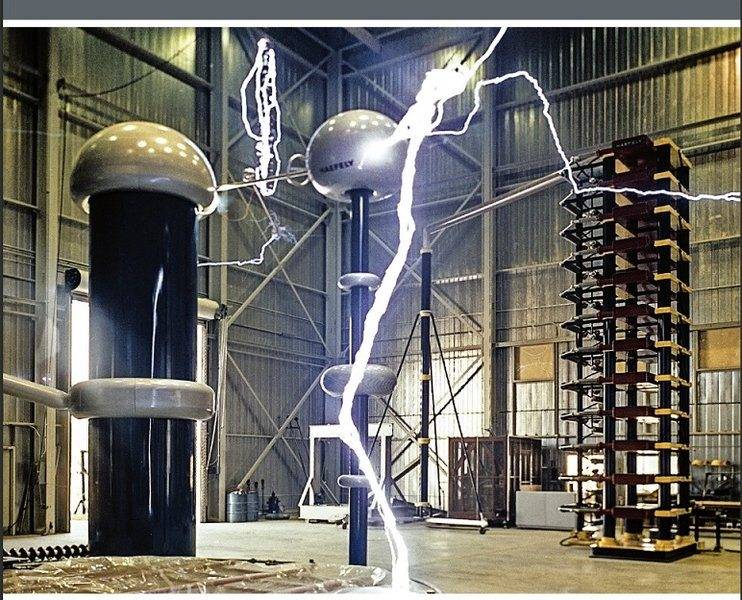

BTW... a Megger could perform the same tests as a hipot... correct ?
Both test insulation.. HIPOT tests I've seen were a bit more elaborate usually on larger machines and higher voltage, "...twice rated plus a thousand".
Likes OCR
jim hardy said:
HIPOT tests I've seen were a bit more elaborate usually on larger machines and higher voltage, ...
On the order of lightning bolts? Any pictures?
I wish i did have some...
Highest voltage in our equipment was the 22KV generator, isophase and and primary side of transformers.
I don't know how the T&D folks check the high side , never got to watch them test one just saw their truck parked by the transformer..
I did see High Voltage Insulators tested once in a factory.
A. B. Chance Co has a million volt VanDeGraff generator that will flash them over.
Senior year we got a field trip to their lab in Centralia Missouri and they threw some lightning bolts for us.
Here's a picture of one from their brochure at https://hubbellcdn.com/ohwassets/HPS/pdf/BR00098E-Hubbell-Labratories-Capability-Guide.pdf
It's an honest bolt complete with ear splitting "Crash" and the metal building reverberates .
Sorry i don't have any photos of our hipot setup. But it is very dull compared to above.
