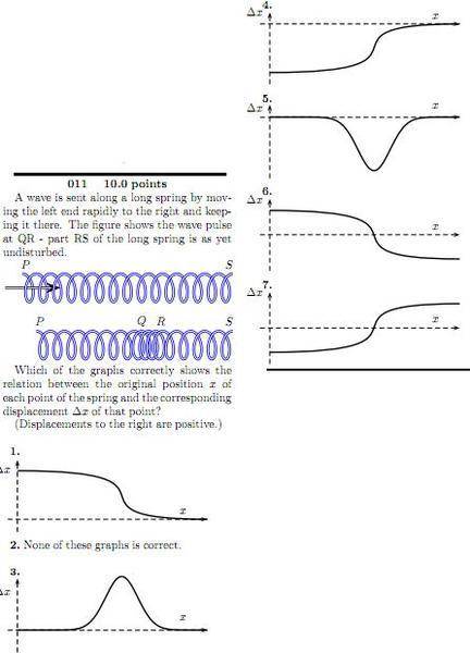

A wave is sent along a long spring by moving the left end rapidly to the right and keeping it there. The figure shows the wave pulse at QR - part RS of the long spring is as yet undisturbed.Which of the graphs correctly shows the relation between the original position x of each point of the spring and the corresponding displacement ∆x of that point (Displacements to the right are positive.)
I think that it is #3 because the displacement at the beginning is 0 correct? Also, the wave part is moving right which means it was displaceed at a positive. Also the end has not been disturbed yet so its diplacement is 0. Is all this correct. if it isn't, could you help me understand it?

#3 cannot be the correct answer. The left end of the spring starts out at x=0 and ends up at x=a, where a is some positive value.
What is Δx at the right end ?
So it would be 1 right??
That looks to me like the best choice.
Can you defend that choice?
1 is the correct answer
