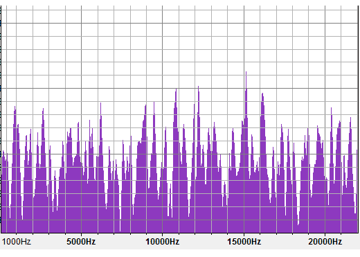

the following is a random distribution in my use of the word, the Ci in the quoted equation above will clearly have a spectra with more structure than the random spectra below.
