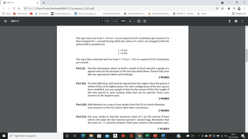

Hi everyone i am trying to solve this coursework for university but i am stuck at the last part of the question. Anyone able to help me find the solution for the last part please?
Can you post the whole question (including whatever was above the text that you posted)? And can you describe your work so far please?
Oh sorry. Here you are

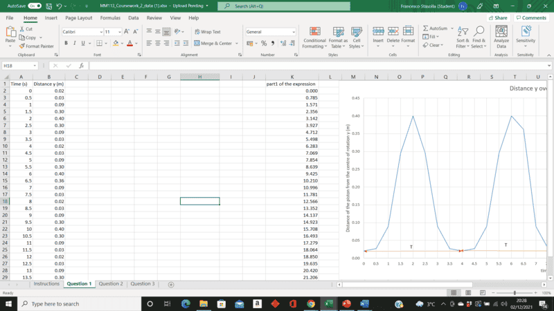

So basically i had to find in the first question the distance y of the piston from the centre of rotation of the crankshaft. I've done that.
I am stuck at the last part of the question which ask to find the minimum value of L to the nearest 0.5m over the period of 1 second but i have no idea how to find that.
No, it asks for the minimum L such that the optimum injection period is at least 1s long.
In part ii you found that period for two cases. Just try different values of L, keeping r+L fixed, to find one where the injection period is at least 1s. Then fine tune that to get the minimum L.

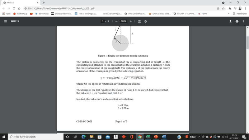

You are told that in one particular set up r=0.1m and L=0.3m. You are also told that r+L is the same in all set ups. So what is the general equation relating r and L?
