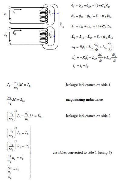

Due to non-linearity of magnetic core of large transformer, Which is excited by pure sinusoidal voltage source, the exciting current isn't perfectly sinusoidal. It can be thought to be composed of pure sinusoidal plus mainly 3rd harmonic component.
But does this current flows in the primary side alone or both side ? If both side, what is its distribution (i.e. Primary / Secondary)
Also, when the transformer primary is driven by pure sinusoidal current source, The core flux don't be pure sinusoidal but will have major 3rd harmonics.
So, this will create non sinusoidal Voltage with major 3rd harmonics, both in the primary and secondary in this case. Isn't it?

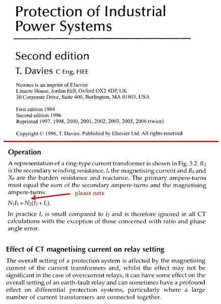

The current transformer is one of single phase transformer types, and effects of magnetizing current in secondary side (protective relays) is one of important terms in electrical protection systems. For similar discussion you can refer to http://electrical-riddles.com/topic.php?lang=en&cat=23&topic=620"

Sorry, I beg to differ. In a single phase current xfmr, the magnetizing current cannot be in the secondary, & must be in the primary. The following illustrates the reasoning.
If the secondary is open circuited, a dangerous condition which should never be allowed in practice, the secondary voltage rises to a dangerously high value. The flux in the core as well as the primary & secondary voltages cannot exist w/o magnetizing current. The secondary is open, but the primary carries current.
When the secondary is loaded w/ a low resistance value, secondary current results in a magnetic flux which opposes the existing core flux. This is a counter-mmf which reduces the net flux in the core. The amp-turns in the secondary almost cancel that in the primary. The slight unbalance is the magnetizing current needed to provide the core flux.
If the secondary is opened (a dangerous condition), there is no secondary current. Hence the counter-mmf is zero, & all the primary current is unbalanced & becomes magnetizing current. This results in a drastic increase in core flux as well as primary & secondary voltages reaching much higher values, & shock hazard is present.
The magnetizing current in a current xfmr is in the primary winding, never in the secondary winding. Any energy conversion text will affirm the same. The "electrical riddles" site provides some interesting discussions & generally good info. However, every single answer is not subject to peer review. You cannot rely 100% on every answer. Even peer-reviewed textbooks used in the best unis around the world have errors which prompt errata sheets being published. No website is above reproach.
I would advise you to carefully examine a contrarian viewpoint before rebuking a well established principle. If the magnetizing current in a CT was really in the secondary, every peer-reviewed text would say so. The fact they don't should give you reason to have doubts about a website that states otherwise. It's just an honest mistake, I'm not dissing the web site. I've posted there, & for the most part it is a pretty good site.
Please refer to attached page.

I am no expert in transformer by any stretch. Claude is the man for that. I just want to put in my 2 cents in the eye of a guitarist. The output transformer is very important. It definitely change the characteristic of the sound by adding harmonics. I notice a very famous brand amplifiers...Mesa Boogie that made famous by Carlos Santanna which he is still using it. I looked at a few of their amps, the output transformer is very small compare to other brands. I bet they are pushing the core into saturation to generate the desired harmonics.

  • #31
Please note to fundamental transformer equation as attached page. As you see, the magnetizing inductance (L1h = w1/w1.M) which related to magnetizing flux and current is related to primary and secondary mutual inductance. Therefore transformer magnetizing current effects is shared between primary and secondary windings (in closed circuit situation) and not related to primary winding exclusively.

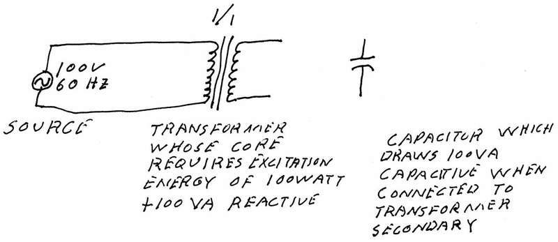

  • #32
My posting was not clear.
There was no intention to imply that capacitive current was transformer exciting current.
Please except my apology.
What was intended was that:
Transformers generally have exciting current that is partly inductive. This inductive current is much higher if the transformer core is poorly assembled or is designed with gaps in the core.
This inductive current can be canceled by capacitive current in the load.
When testing high voltage transformers, the total volt-ampere required can be less than that of the core alone.
It should be easy to do a demonstration where the exciting current of a transformer decreases when a capacitive load is applied.
The test could be done on a small transformer which has a gap deliberately placed in the core.
I wish to emphasize that I'm not implying that the secondary current in any way can supply watts to energize the transformer core.
I'm only saying that the secondary can provide some or all of the reactive current that is required to energize the transformer.

  • #34
But the effect of magnetizing current upon the secondary does not mean that there is magnetizing current in the secondary. The mag current establishes the core flux, making secondary voltage & current possible. But there is very little mag current in the secondary, less than 1% per my previous post.
