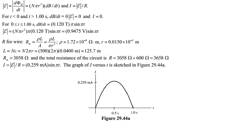

That is my solution:
i solve my problem without ø=30°, I confused what this angle was used to do?
Think about what your first formula is actually saying. It the rate of change of the flux through the coil. If the table was flat would there be any flux through it?
If the angle was 90 degrees would there be any flux through the coil?
