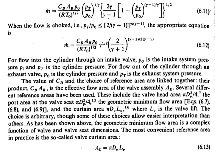

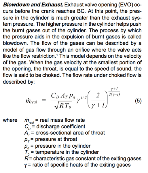

This is what's confusing me. What do they mean by pressure at the throat? How can cylinder pressure or cylinder temperature be a variable? Isn't Cylinder Temperature Dependent on Cylinder Pressure? Isn't that (Pressure) what we are trying to look for? Even if we rearrange the equation, we still have an unknown mass flow rate, which, coincidentally, is dependent on cylinder pressure and temperature!...?
First, make sure you use absolute temperatures (Kelvin or Rankine) and pressures (referenced to zero, not to ambient). These equations are thermodynamic in nature, and require absolute measures of those quantities.
Second, I don't know why that image you just posted lists the pressure at the throat since it doesn't appear in the equation. That said, it's a pretty easy quantity to calculate given the upstream conditions and the contraction ratio from the reservoir to the throat.
Third, temperature is related to the pressure (and density, for that matter) via the ideal gas law, ##p=\rho \bar{R} T## or ##p = m R T## according to your paper you are citing. Given that your cylinder is discharging air, the pressure and temperature inside will therefore be a function of time, and therefore variable quantities. How they relate to one another will also depend on your cylinder's interaction with its environment. The second equation you mentioned, ##T/p^{(\gamma-1)/\gamma} = C##, is based on assuming the flow is isentropic, meaning it is both adiabatic and has no dissipation.
Last, the mass flow rate does depend on the pressure and temperature (and throat size), and yet the pressure is also dependent on the mass currently inside the cylinder, and therefore the mass flow rate. This is an example of a real-world situation where, to solve the problem, you need to employ differential equations.

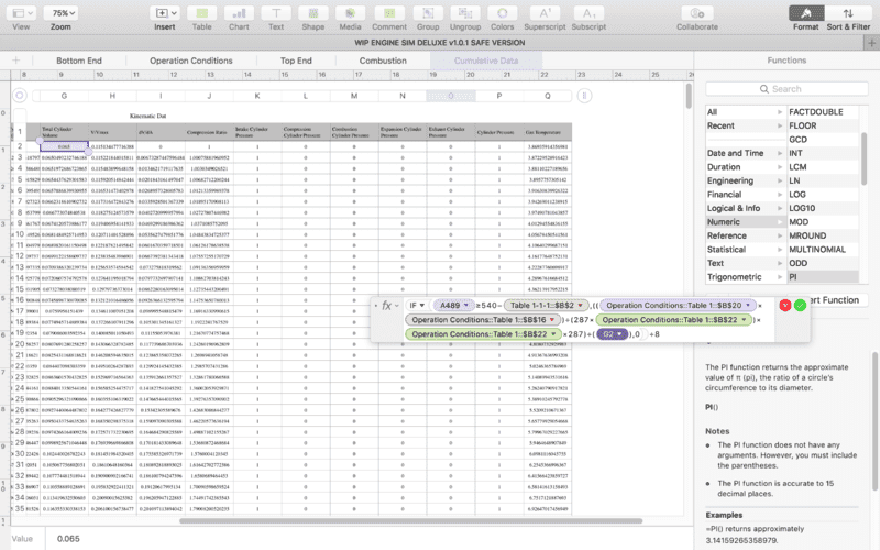

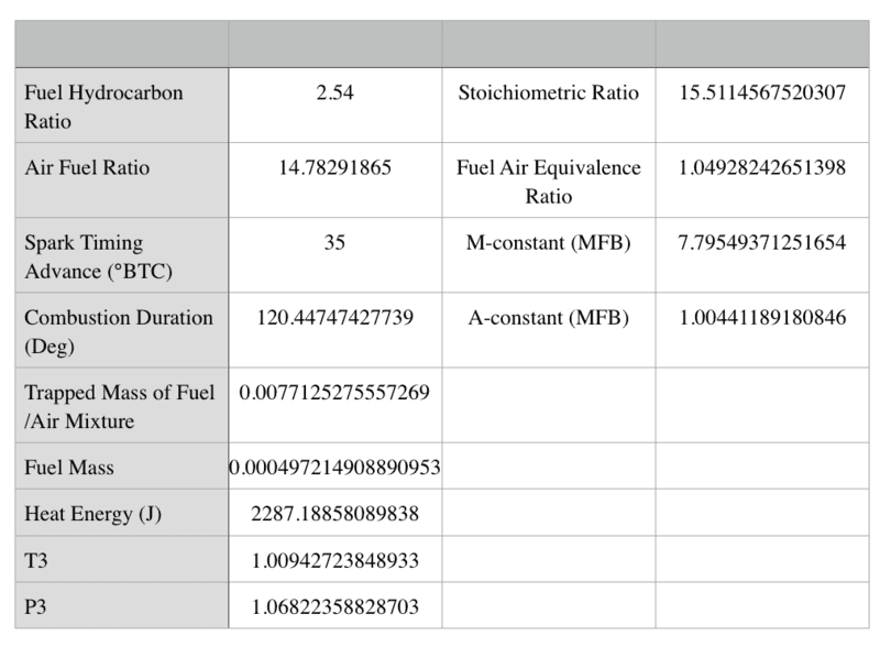

Here are the data in my spreadsheet so far. I am so close! :headbang:
boneh3ad said:
Well, lay out what you know. You know an expression for ##\frac{dm}{dt}## in the bottle and you know an expression relating ##p##,to ##\rho## and ##T## in the bottle and a way to relate density to the mass in the bottle, right? So therefore you should be able to find something that looks like a differential equation for ##p## as a function of time.
I have uploaded a few photos, but I'm still not quite catching on.
In the document, it says (after equation 6):
The pressure at the throat is equal to that of the gases in the exhaust system.
In this case, we are looking for the mass flow rate going out of the cylinder. All pressures and temperatures should be already known at this point.

In your OP, you have 2 equations with 2 unknowns, namely pressure & temperature. These equations represent the conditions inside the cylinder. You can then find these values easily.
If you exhaust directly to the atmosphere, you can assume the exhaust pressure (the one in the exhaust pipe, i.e. at the back of the exhaust valve) is the atmospheric pressure.
Jason Louison said:
And is the "throat" the throttle body?
No. It is the "throat" formed by the exhaust valve opening, i.e. the smallest area where the fluid flows.
This opening will determine how much gases exit the cylinder, giving you a new value for ##m## inside your cylinder for ##PV = mRT##.

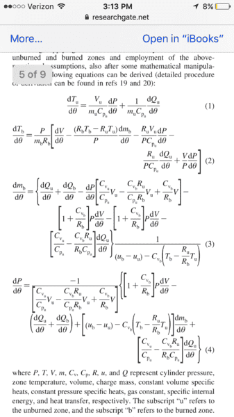

I found this in a PDF I downloaded awhile ago:
Can you tell me exactly what I'm looking at here? Can I use an arbitrary value for PT, like 1 atmosphere? Also, is P0 the variating cylinder pressure, as well as T0? How would I differentiate this?!
The exact same equations as (5) and (6) in your previous reference (kuo.pdf). I'm not sure what you are not understanding.
It's not arbitrary, if you exhaust into the atmosphere, then it is 1 atm.

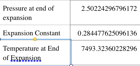

Would I be okay using these values for P0 and T0? I had already had them calculated before hand.
It depends what «at end of expansion» refers to. Usually, the exhaust valve opens before bottom dead center, so the exhaust process begins before the expansion process is completed.

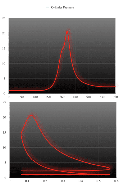

SO CLOSE! But I don't think that the function is valid, because it depends on volume starting at the very beginning of the cycle, and not the instantaneous volume.

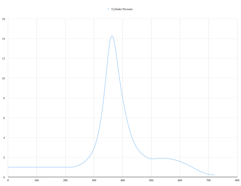

It looks okay, but the spreadsheet can't really handle a function that depends depends on the value of the last function. If I copy the formula down for all the columns, which is the only way to simulate cylinder pressure properly, as the statements are conditional, it results in erratic values or even critical errors. :frown::oldcry:
I don't see why not. Of course, the first function cannot depend on the last one, but you can compare the results where the answer of the first function must equal the answer of the last function ( ##\frac{x_1}{x_2} = 1## or ##x_1 - x_2 = 0## ).
  • #31
I'll just use the equation that depends of volume a the start of the cycle, It seems to work pretty well, but now I need to find out how to simulate valve overlap!
