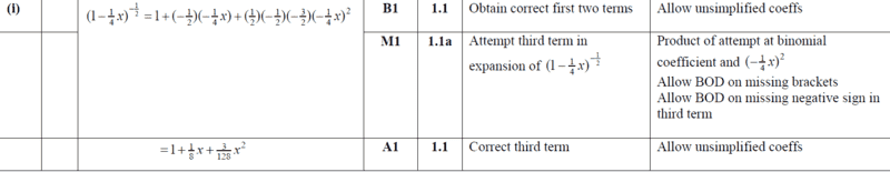

See attached problem with ms
binomial theorem
Find question here and ms... In part ##i## we could just as well expand directly hence reason why i am sharing...
My direct expansion for part (i),
$$(4-x)^{-\frac{1}{2}} =4^{-\frac{1}{2}}+\frac{(\frac{-1}{2}⋅4^{-\frac{3}{2}}⋅-x)}{1!}+\frac {(\frac{3}{2}⋅\frac{1}{2}⋅4^-\frac{5}{2}⋅(-x)^2)}{2!}=\frac{1}{2}+\frac{1}{16}x+\frac{3}{256}x^2+...$$

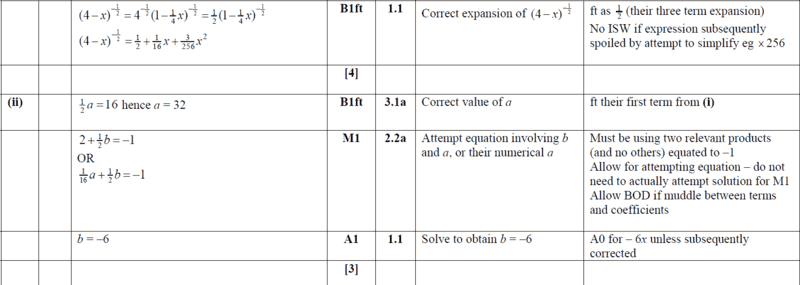

part (ii) follows directly from (i),
##(a+bx)(\frac{1}{2}+\frac{1}{16}x+\frac{3}{256}x^2+...)=16-x...##
##\frac{1}{2}a+\frac{1}{16}ax+\frac{3}{256}ax^2+\frac{1}{2}bx+\frac{1}{16}bx^2+\frac{3}{256}bx^3+...=16-x...##
giving us the two simultaneous equations indicated. cheers
As an alternative way
(\frac{a+bx}{\sqrt{4-x}})_{x=0}=\frac{a}{2}=16
a=32
(\frac{32+bx}{\sqrt{4-x}})'_{x=0}=\frac{b+4}{2}=-1
b=-6
a=32
b=-6
Smart move there @anuttarasammyak ...just wondering if this approach would be acceptable, i.e substituting ##x=0## directly ... are we not supposed to make use of part (i) though?
I can see that its a B mark, thus acceptable...cheers
