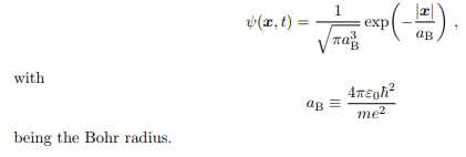

How should I calculate the expectation value of momentum of an electron in the ground state in hydrogen atom.
I am trying to apply the p operator i.e. ##-ihd/dx## over ##\psi##. and integrating it from 0 to infinity. The answer I am getting is ##ih/{2(pi)a^3}##

You are actually trying to calculate the expectation value of px. To do that, you must express the ground state wavefunction explicitly as a function of ##x## so that you can take the derivative. You have to do a 3d integral.

So I did the following to integrate it in 3d:$$ \iiint_V \Psi^* (-i\hbar) \frac {d\Psi} {dr} r^2 sin\theta dr d\theta d\phi$$
The final answer i am getting is ##\frac {i\hbar}{a_b}## which does not look right because it is imaginary and momentum operator is hermitean. I can't figure out what mistake I am doing
You are assuming that in spherical coordinates ##p_r=-i \hbar \frac{\partial}{\partial r}.## It is not quite that. Do some research on the internet to find out what it is and why.
