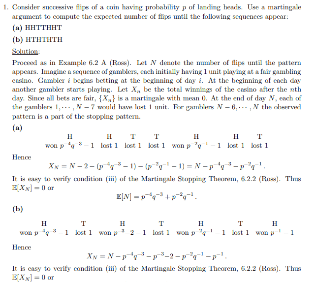

Expected number of random variables that must be observed before any specific sequence.
In my opinion, answer to (a) is ## \mathbb{E} [N] = p^{-4}q^{-3} + p^{-2}q^{-1} + 2p^{-1} ##
In answer to (b), XN is wrong. It should be XN=p-4q-3 - p-3 q-2- p-2 q-1 - p-1. This might be a typographical error.
Is my answer to (a) correct?
Please explain your reasoning.
For b) I agree with you.
Answer to (a) given by author is correct. My answer is wrong. Thanks for bringing my error to my notice.
You are welcome.
I had never seen this method before. It's brilliant- thanks for posting.
