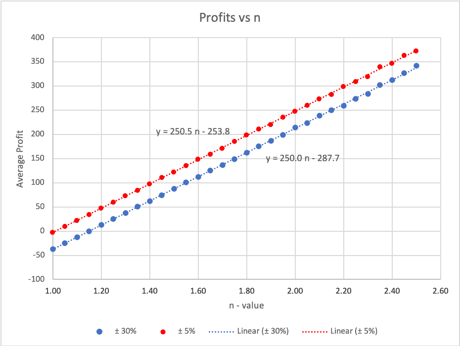

I thought it might be worthwhile to extend this discussion by replacing the clueless buyer, who bids sight-unseen, with a savvy buyer who is allowed to evaluate the property and put in a bid randomly selected within the range ##\pm f V## (##f<1##). The same filter ##B > V## and profit formula ##\text{Profit}=nV -B## apply. The results are shown below. The two datasets correspond to two levels of savvy buyer: in red a real estate broker who can evaluate a property to ##\pm 5\%## of its value and in blue an amateur whose accuracy is ##\pm 30\%##. The dotted lines through each set of points represent the results of linear fits with the equations shown next to each line. I also did a simulation for the original question (clueless buyer) that produced the linear fit $$\langle \text{Profit} \rangle_{\text{clueless}}=\frac{V_m}{3}n-\frac{2V_m}{3}$$where ##V_m## is the maximum value of the property, here equal to 1000. I do not show this on the same plot because it will crowd out the other two plots and does not say anything new. It confirms what has been already stated that the breakeven point is at ##n=2##.
Now for the math. The probability that the value of the property be between ##V## and ##V+dV## is ##dP_V=\dfrac{dV}{V_m}.## The probability of the bid being between ##B## and ##B+dB## is ##dP_B=\dfrac{dB}{2fV}.##
The expectation value for the profit is given by $$\langle \text{Profit}\rangle _{\text{savvy}}= \int_0^{V_m} \frac{1}{V_m}dV\int_{V}^{V+fV}\dfrac{(n V-B)}{2fV}dB=\left[n-\left(1+\frac{f}{2}\right)\right]\frac{V_m}{4}.$$With ##V_m=1000##, the theoretical predictions are $$\langle \text{Profit}\rangle _{\pm~30\%}=250.0~n-287.5~;~~\langle \text{Profit}\rangle _{\pm 5\%}=250.0~n-256.25.$$These compare favorably with the simulation fits.
Note that the breakeven value is ##n=1+\dfrac{f}{2}## and decreases as ##f## decreases. The more accurately one is capable of assessing the value of the property, the more likely one is to turn a profit on average. This is in sharp contrast with the clueless bidder who needs ##n > 2## in order to turn a profit.
Moral: A pig in a poke is worth about as much as two birds in the bush.
On edit: I forgot to say that the "experimental" results shown in the figure come from a Monte Carlo simulation on an Excel sheet. Values and bids were randomly selected after which the filter was applied and the profits calculated. There were 40,000 bids of which half (as expected) were successful.
