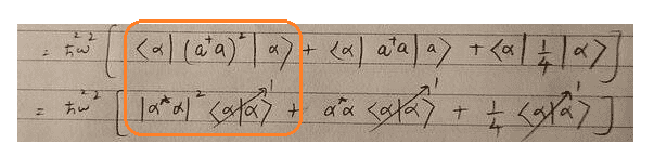

Check the step circled in orange. ##a^\dagger## and ##a## don't commute.
Likes vanhees71 and Terrakron
Yes, but how to do it the right way?
Please post the steps for how you reduced ##\langle \alpha | (a^{\dagger} a)^2|\alpha \rangle## to ##|\alpha^*\alpha|^2 \langle \alpha | \alpha \rangle##. That way, we can help you see where you made a mistake.
